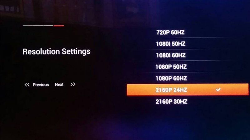

For those who didn't have a chance to grab the "NA Amiko A3" recovery files before FridgeFTA closed it doors, I found a European dealer that provided a YouTube tutorial and NAND files. Since, we no longer have "NA support" for the A3, you can download the recovery files and then import your satellite settings. I used those files this last time around to recover my A3. To my surprise, it features video resolutions of up to 2160p. The download file contains a lot of stuff we don't need here. Most of all it wasn't altered to the so called "NA Version". Let me see how this behaves in the next few weeks. So far, I haven't had the constant strange behaviors from the A3. Keeping my fingers crossed.

Has anyone seen 2160p resolutions in the display settings at setup?
I can select the 2160p options but the output doesn't actually go there. The TV reports a 720p input.
