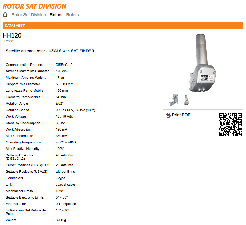

Should I just buy a new motor?
A Stab HH100 was mentioned. I'm thinking no, let's go with the HH120 so I can put a bigger dish on it if I want to.
It says it will support a 1.2m dish up to 17kg which is about 37lbs. The dish I have on it now is 1m and MAYBE 20lbs.
Specs on my SG9120 motor say 350mA power draw. That should be well within the safe zone for the A3.
So there's no reason it shouldn't work.

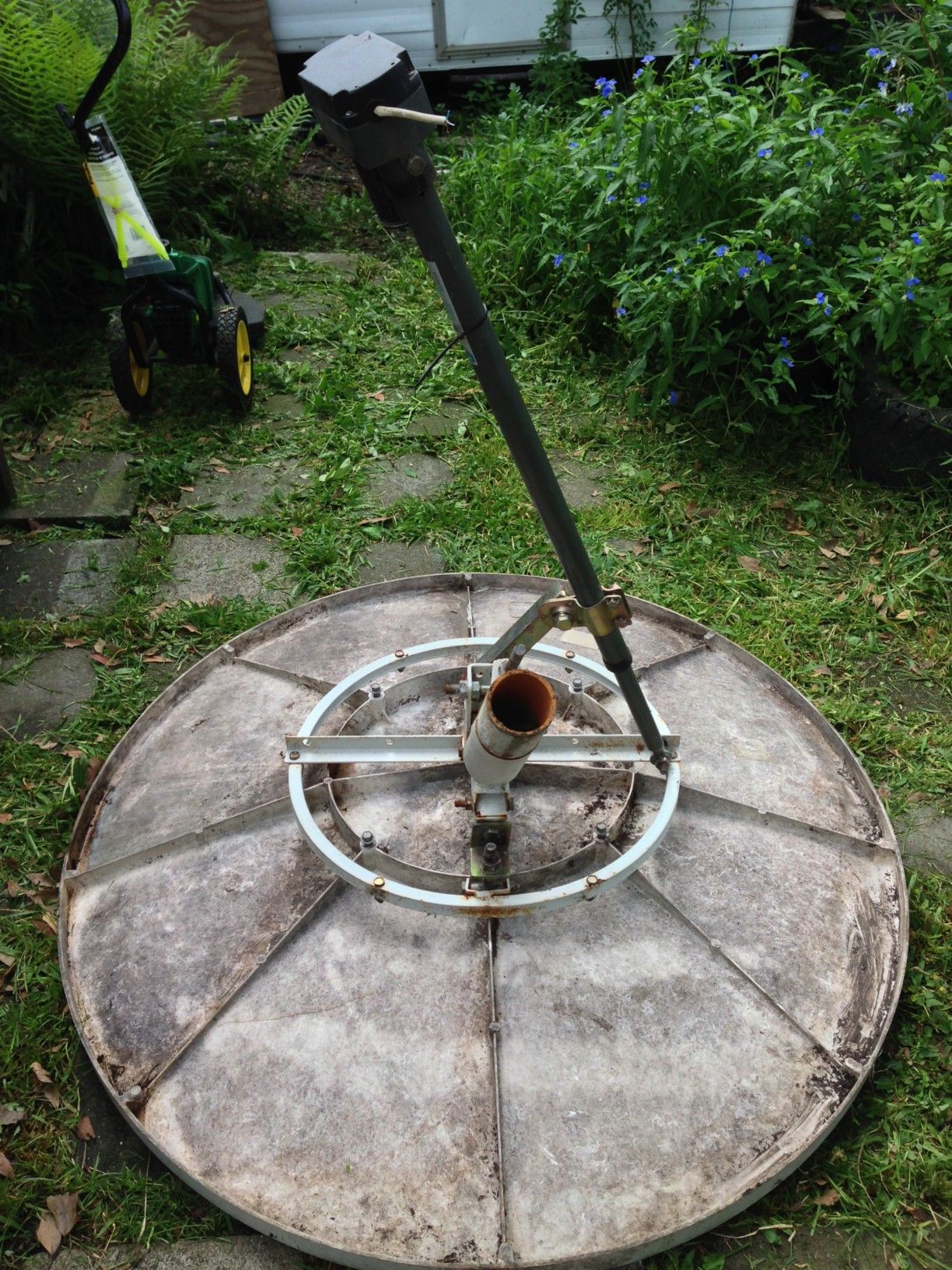

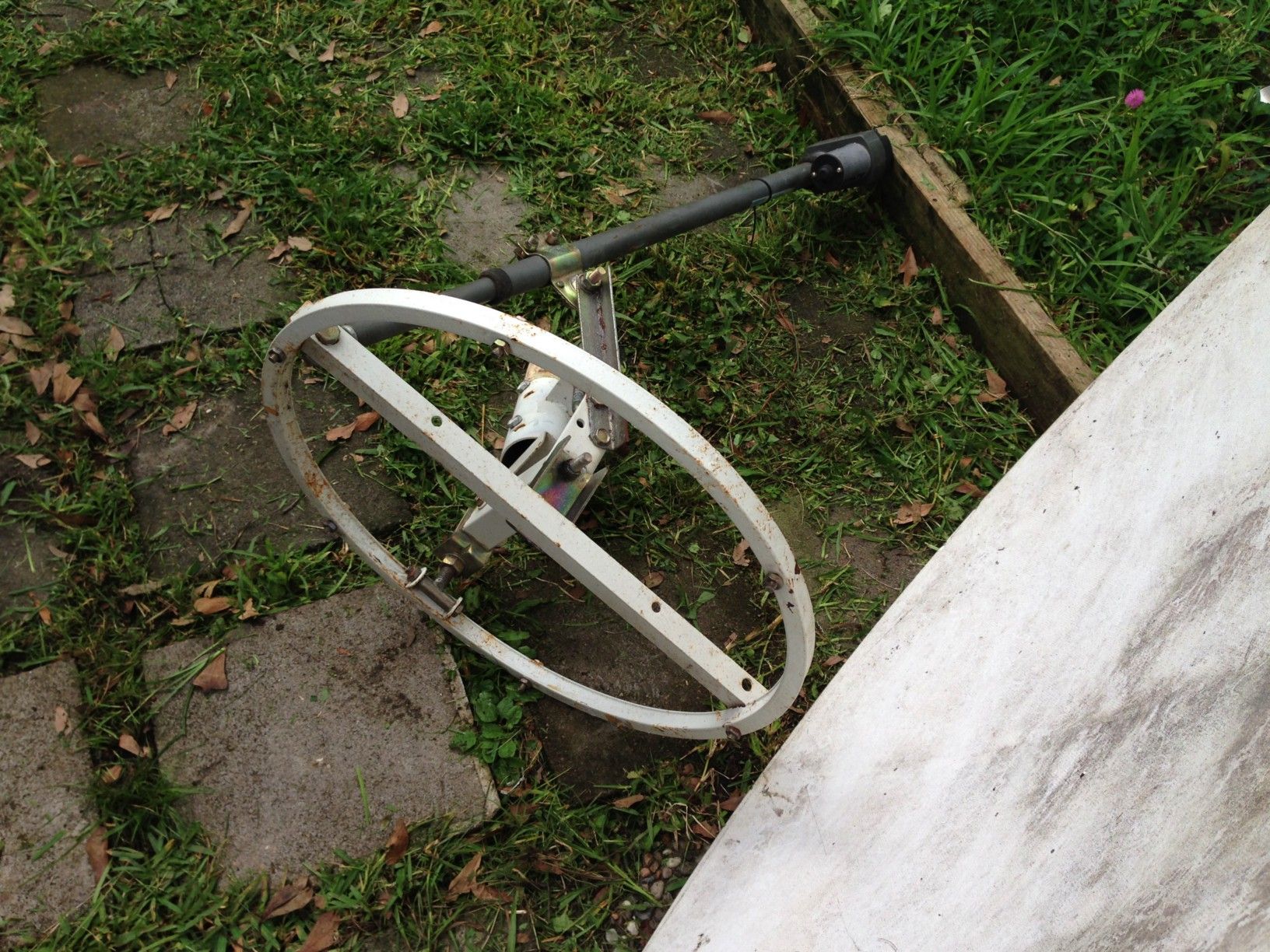

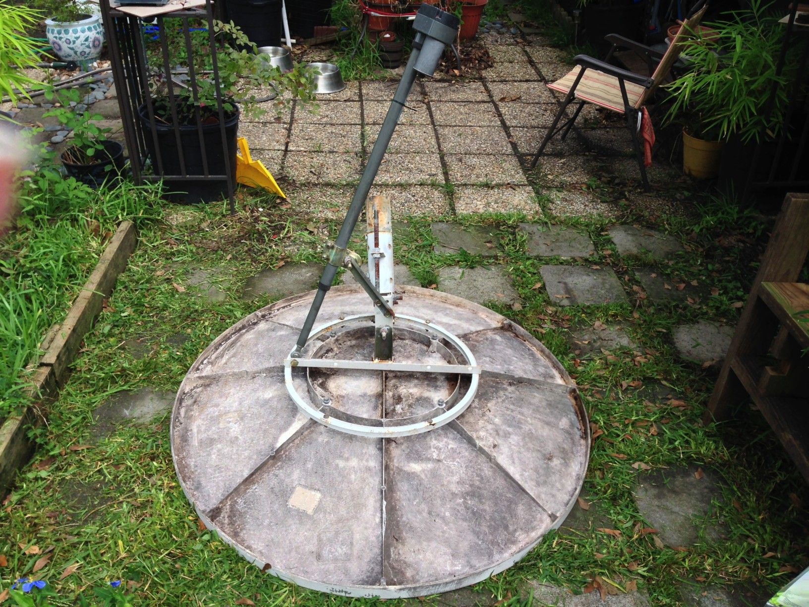

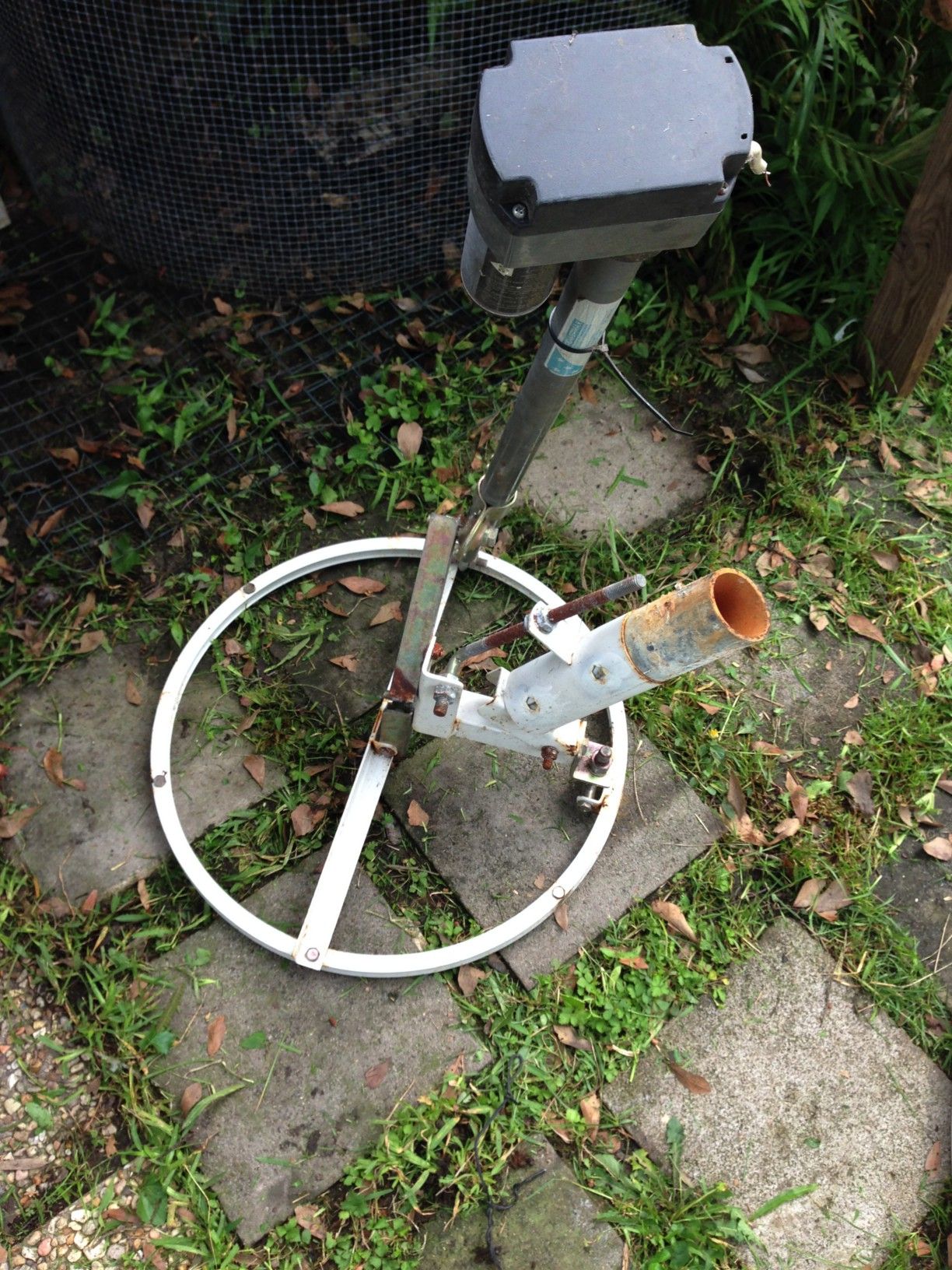

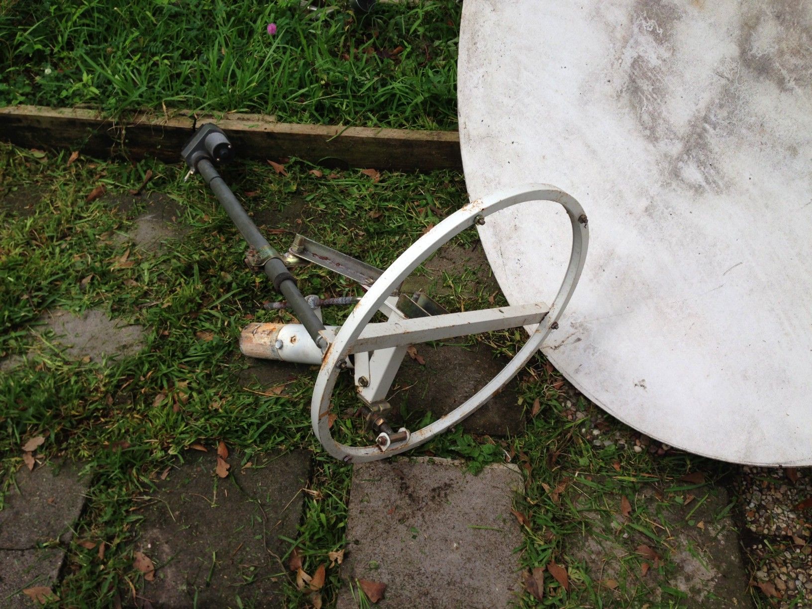

Also, I have another idea. Rather than depend on a wimpy little motor and a wimpy little STB to control the wimpy motor,
how about just building a C-band style KU dish? I have a spare dish and I have the stuff left over from that junk WSI "special" 6' dish.
I could mount the dish to that and then have a second ASC-1. Chain the two controllers, one controls the C-band dish and it uses odd numbers for the satellite positions.
The other uses even numbers for the KU dish.
Would that not work?

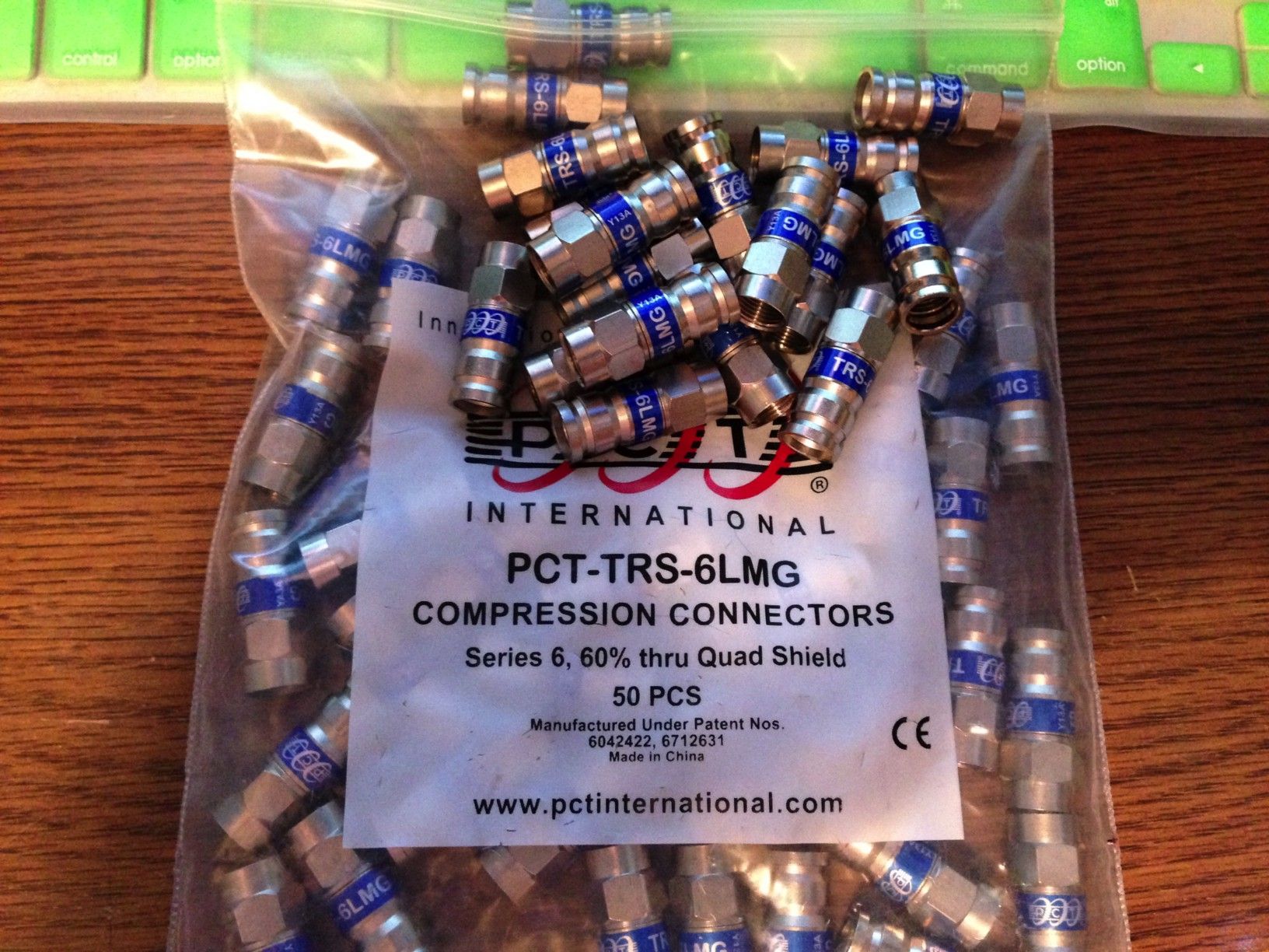

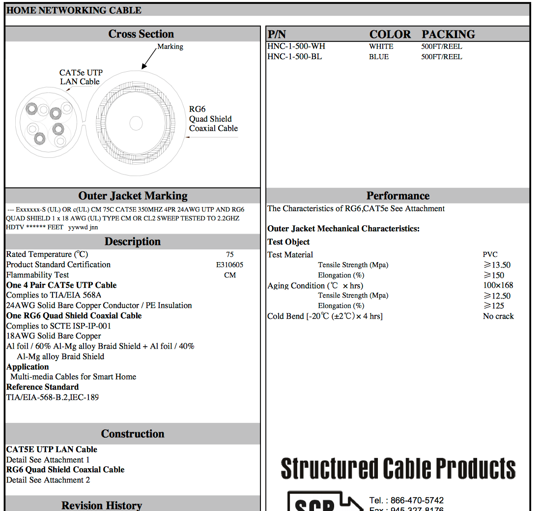

This is the wire I'm using. It's only 40 feet from my STB to the dish. Add another 6 feet inside the house and another 8 feet where is comes out of the ground to where it connects to the motor.
All in all, it shouldn't be any more than 55 feet total. The connectors are new.

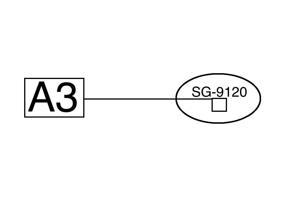

This is how it's connected now, there are no switches of any kind, just a straight wire from the A3 directly to the motor.
I don't know if this is an issue but I seem to have lost all of LPBS on 87w KU now.
It had been coming in fine on this dish and the MicroHD.
How can the A3 and the MicroHD BOTH be connected to that motor at the same time with straight cable, and no switches?
