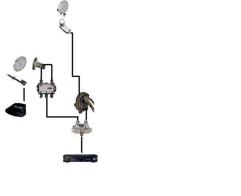

Here's one method to avoid the KU motor using a Ecoda switch, It assumes your LNB is not universal.

Hey Pedro,
That is a simple solution. My situation would even be easier in this case because I don't have a KU/C lnb on the BUD so there won't have to be a diseqc switch any where.
The only thing is that in this original thread, the use of a 2.3 GHZ splitter is suggested. And of course my original question was/is, whether this is true &, if so, what type of splitter?
I found some splitter switches unreliable and do not actually do what they indicate but the Ecoda is 100%. The Ecoder switch will also take the motor current draw no problem.
If you can dispense with the diseqc great less signal loss.
Radar > There have been a number of threads of poblems using C & Ku through a motor with unsolved problems and I am still not convinced it is a motor problem. WRDavis had a complex system with strange occurences thought to be 22hz at first. it was resolved by a set up change but it would have been nice to have solved the problem /fault
