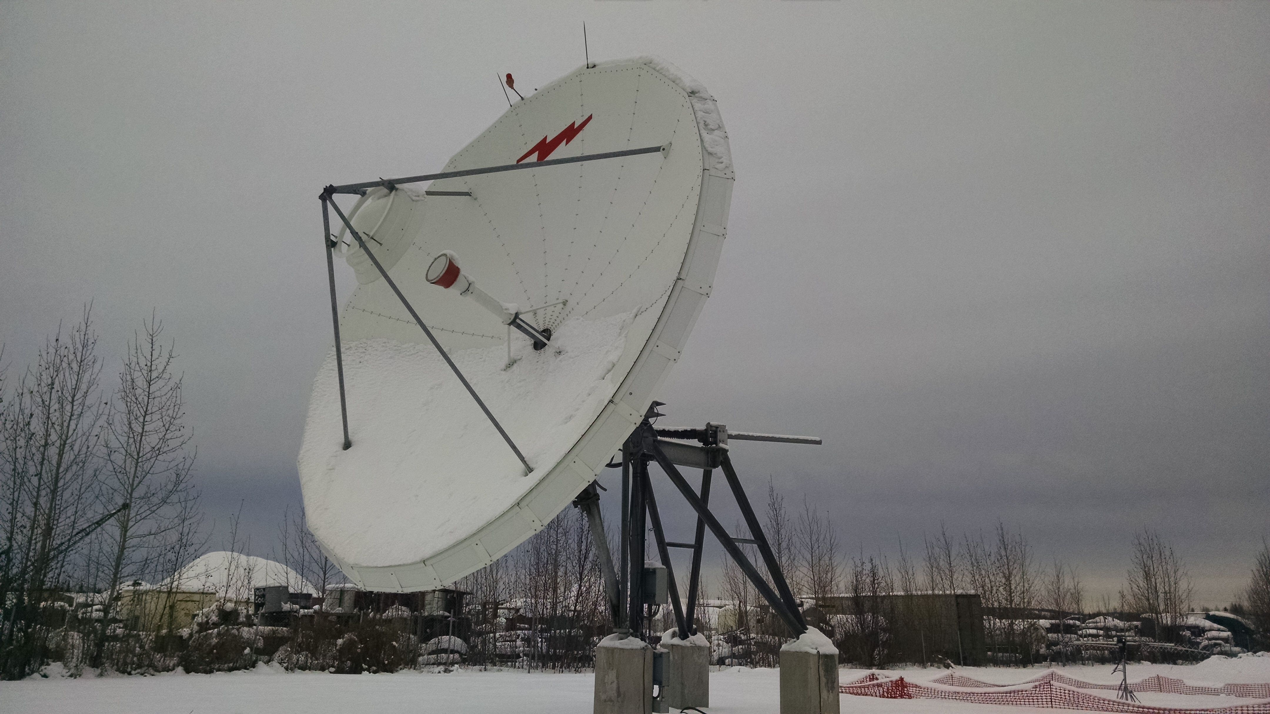

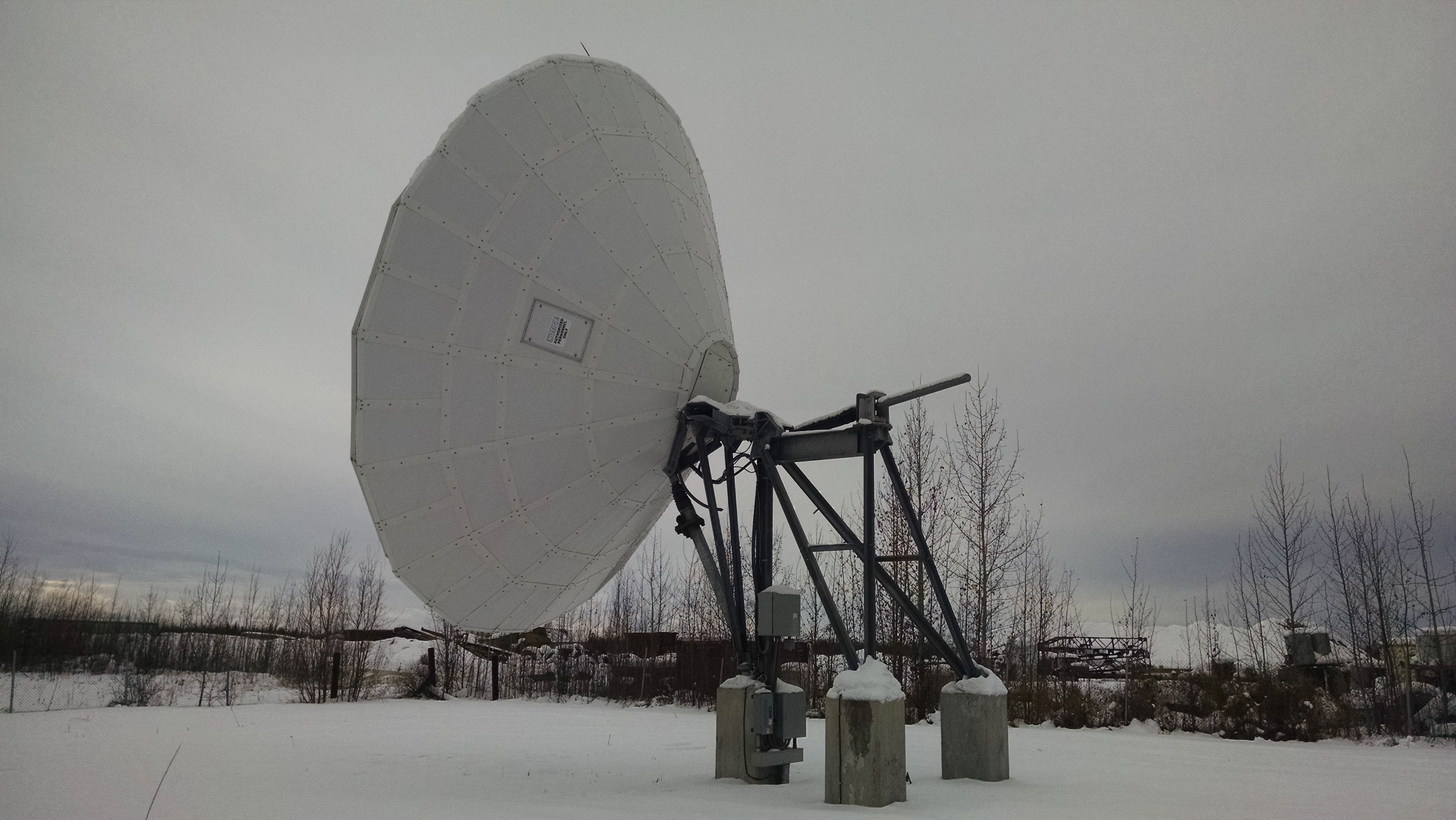

it is a 9 or 10 meter dish... see the pictures. a lot of work to move it 15 miles. Not sure but I think it is Ku only, so how easy to make it c and ku? Looks like it moves but I'd have to skew polarity, so not that easy to scan the arc... The gain would definitely be beneficial as I am in a fringe location for footprints.
see the pictures

Expensive dish.$150,000 maybe with the complete control system. It's three axis control includes skew.
You would need a crane to move it not to mention all the prep and concrete needed to make a new pad for it. And I think finding a replacement LNB would be a tough one. :)
That would cost a ton to move. :) if you got the funds do it!!!
Not many folks have a dish that big in the back yard. I think if I tried The wife would move out or make life hell until it was gone. I would buy a farm and start a sat farm :)

If I had the money, space and open horizon...... :)
It may not be transmit compliant for KU, but I am sure that it would do fine for KU receive. Your aiming would need to be spot on and probably even track the KU satellite within the box. In the course of station keeping the satellite would move in and out of the narrow KU-band beam width of a 40' dish.

Is that an aviation obstruction light on there? If so, make sure the FAA will allow the dish at your location and that you can comply with the FAA regs. (I guess it could just be a 'transmitter on' light.
Big project, but could be worth the effort. Maybe that entire feed setup could be scrapped for a simpler more conventional fta style?
L~O~O~K at the SIZE of that actuator!!!!!!!!!

I'll have to ask if I can get the control unit... original owner was probably smart enough to sell it as the dish was left behind. I'd probably take it apart and rebuild it over time vs crane and semi trucks.
I have a SE view on a mountain, so it would be dug into mountain to keep it low and clear trees to see the horizon of 80W to 139W (wondering how far in azimuth it can swing?)
Reactions: Titanium
Is it possible to add temporary "axis", in order to spin the dish, so, only the lowest part could be dismantled?
Are the bolts holding front and back segments (panels) to the internal ribs easy to unscrew? Are they stainless, or aluminum, or, rusty steel?
Each quarter of this dish (four segments) could make respectable offset dish on its own...
