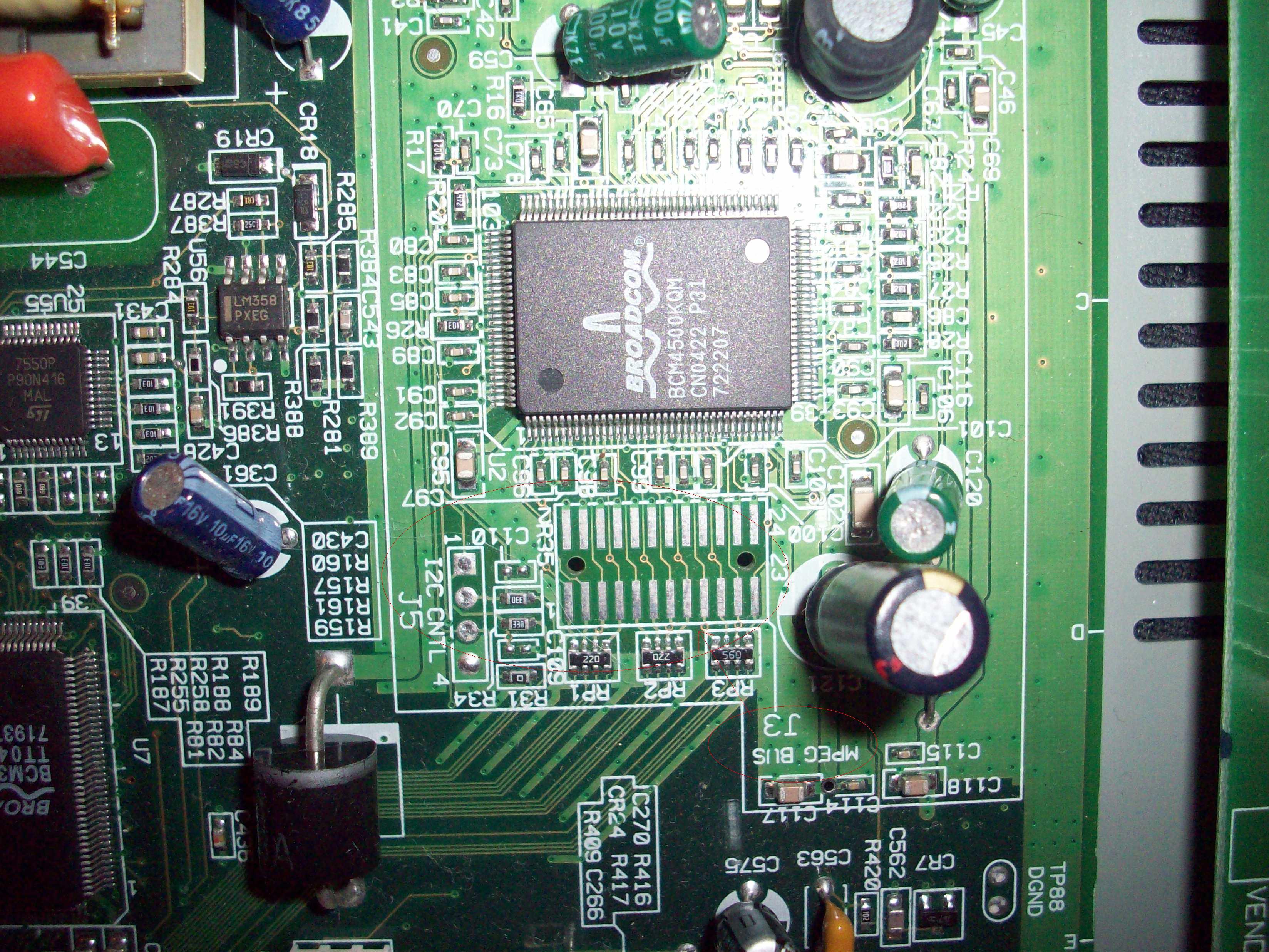

Hey guys a Dish381 just fell in my lap and I want to make use of it.
There is a picture attached. It doesnt take a genius to realize connecting lnb controller, eeprom, and fx2lp to the i2c bus and the fx2lp also to the mpeg bus. Its all documented at cypress here Implementing an 8 - Bit Parallel MPEG2 - TS Interface Using Slave FIFO Mode in FX2LP - AN58069 - Cypress Semiconductor and a real world example here FX2LP DMB - T/H TV Dongle - Cypress Semiconductor
I was aware of Genpix and DVBTech, but did not realize the developer of TSReader also made turbo 8psk product.
After searching some satguys archives, I found references to a USB turbo 8psk adapter made by others. I have never owned any of the three USB products, but I am not surprised they also use the fx2lp.
I am at a crossroad here. The second paragraph in this post sums it up best. http://www.satelliteguys.us/57617-8psk-usb-adapter-pcs-2.html#post497995
If I have to analyze the I2C bus then so be it, but I thought I would ask here if these BCM4500 datasheets have since become public?
Also if anyone can sum up other DIY 8psk>USB adapters mentioned here and on other forums besides dvbtech and genpix products please do.
