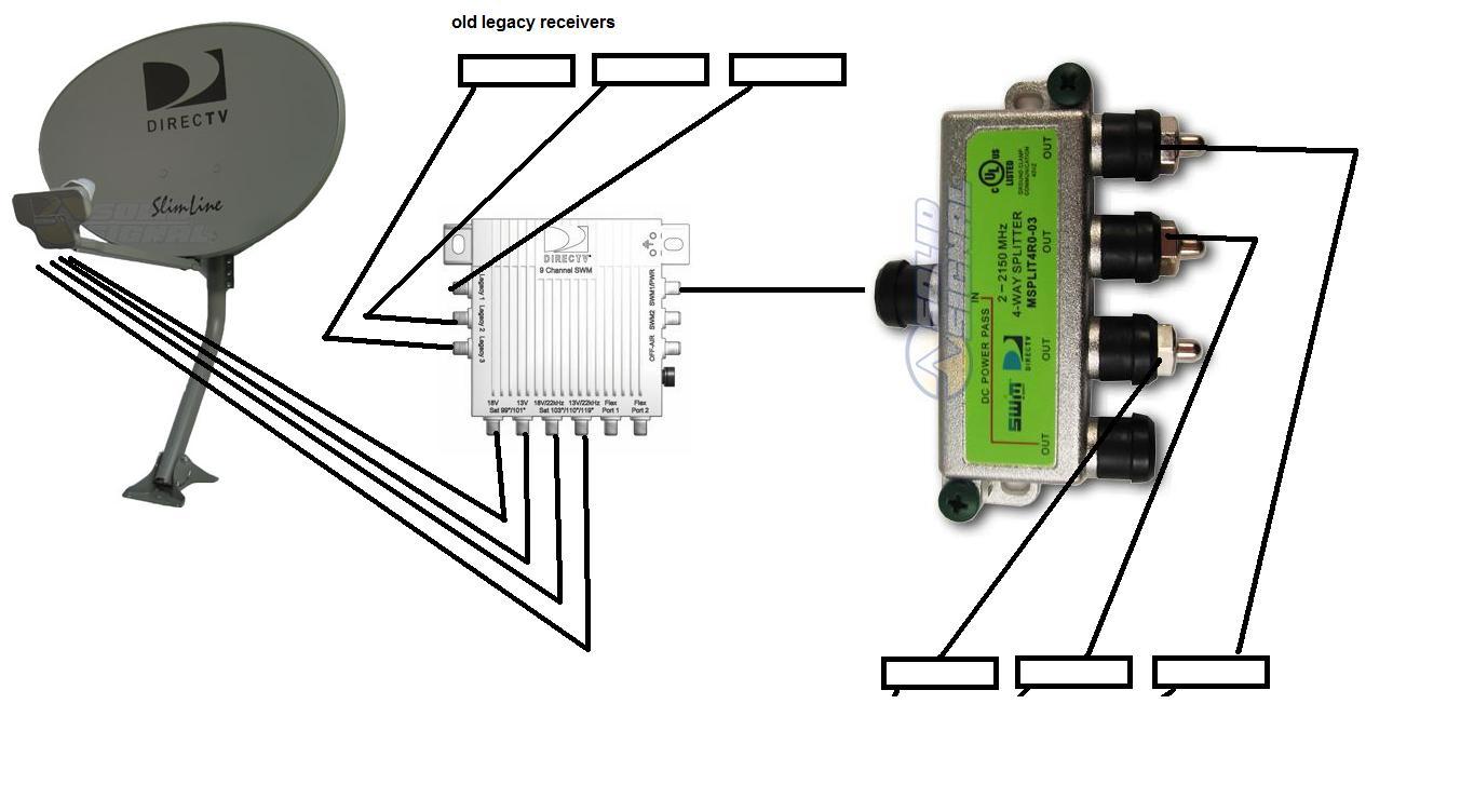

You'd have to run all 4 lines to the SWM8 multiswitch. This is what it looks like
DIRECTV SWM-8 Single Wire Multi-Switch (8 Channel) (SWM-8) - DIRECTV - SWM-8 -

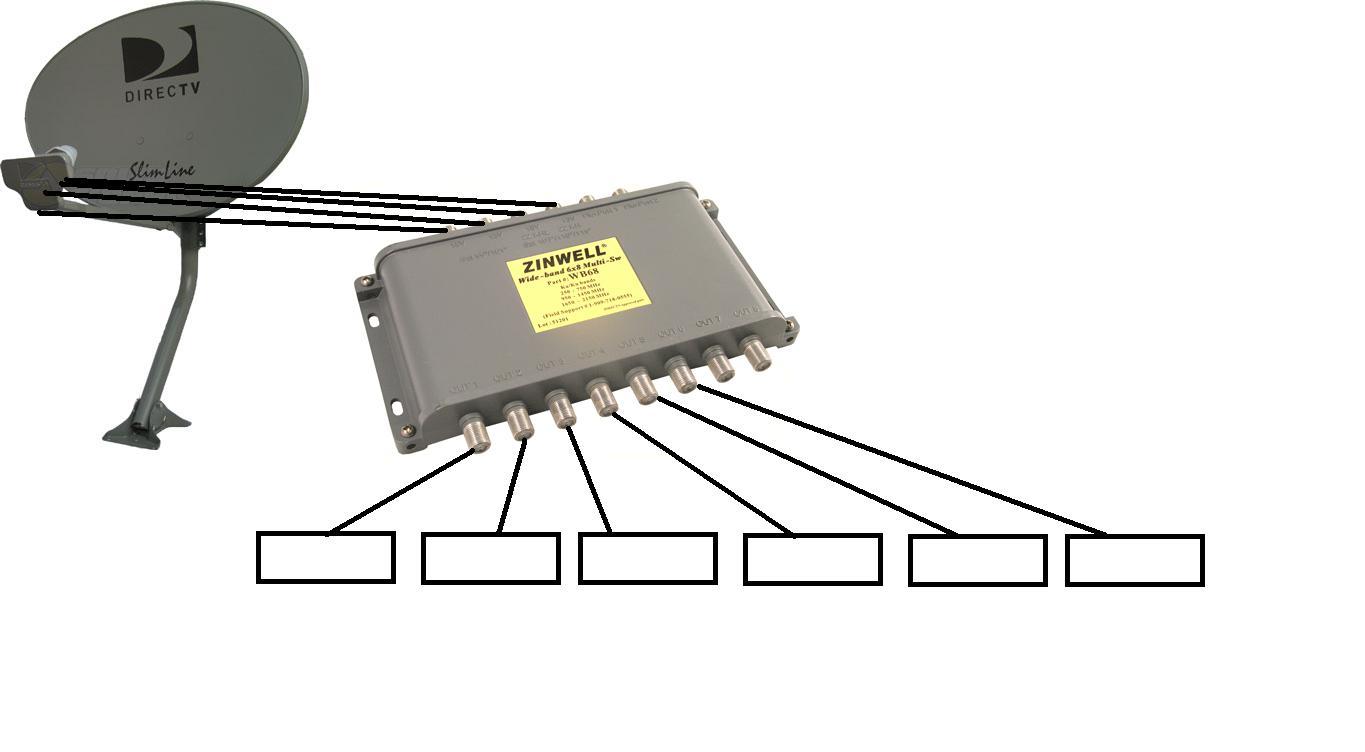

It has one output for a splitter for the 3 HD units and 3 "Legacy" outputs for the older receivers. But if the receivers (the new ones) are not DVR's you could use a 6x8 multiswitch instead
Zinwell WB68 DIRECTV Approved Wide Band Frequency (Ku/Ka) 6x8 Multiswitch (WB68) - Zinwell - WB68 -
If you go the 6x8 route you would need BBC converters on the HD units. If I remember right, Directv will supply them for free

ok pics of install
1st is the SWM8 multiswitch
2nd is the 6x8 multiswitch

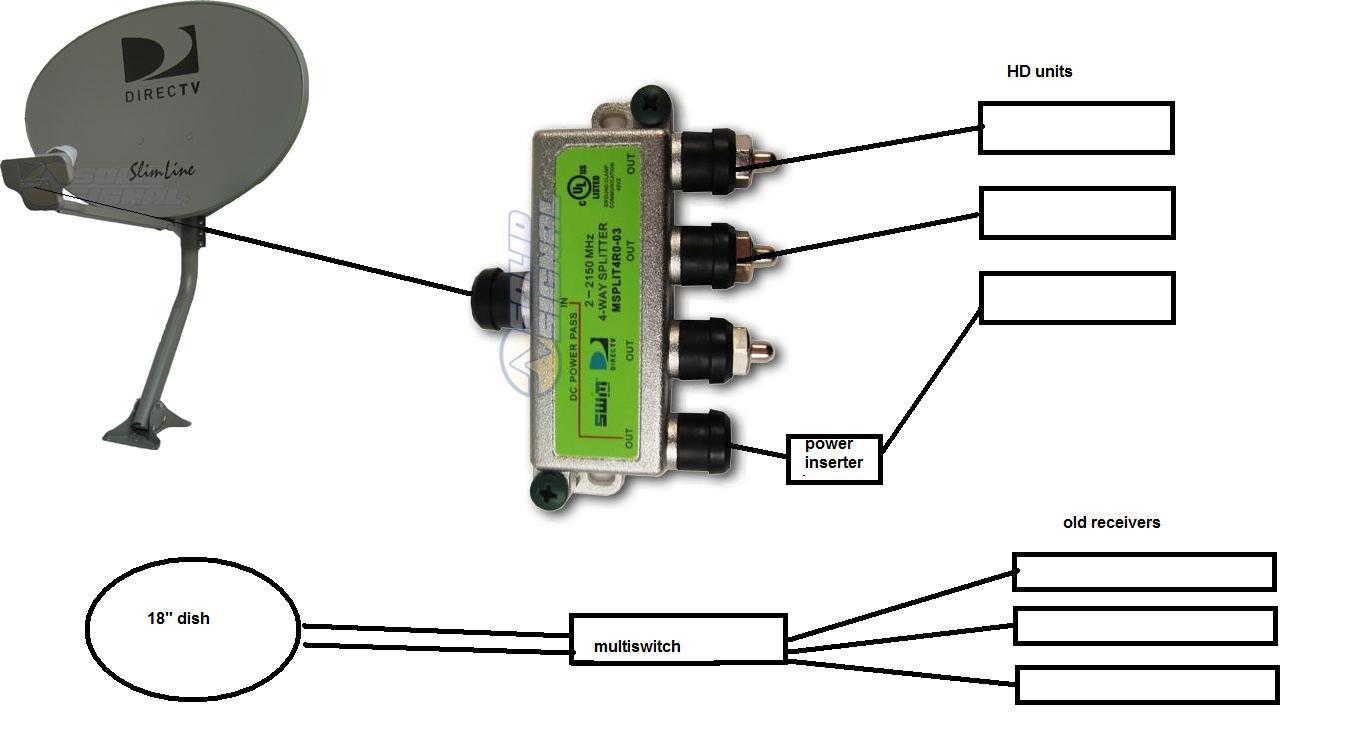

If you kept the old units on the 18" dish you could use that setup (even a 4 way splitter instead of an 8 way) for the new receivers and all it would require is one more line from the roof
Here is a pic
