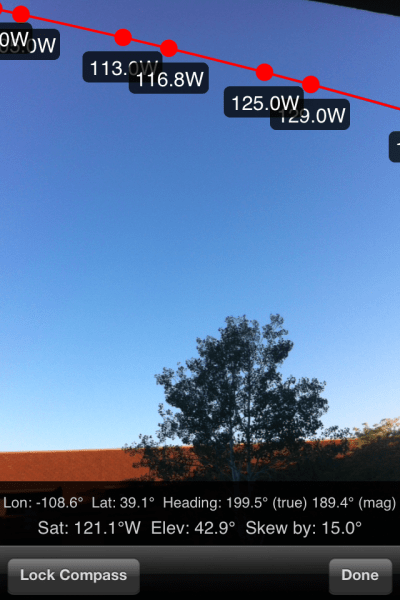

I might be able to help with the non-rule-related questions
1: it'd be some app besides the regular camera. Here's a screenshot I took while using Dispointer (on iOS, but should work the same in Android)

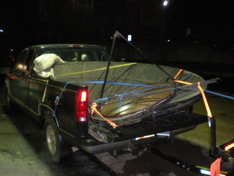

Today was a good day... We have now been blessed with a Unimesh for Christmas. The gentleman we got it from couldn't have been more nice. I tell ya the guys from the WWII & the Korea era have a level of class about them. It's really hard to put your finger on it but i'm sure you guys know what i'm talking about. My best friend who is a pilot calls my dad and his dad real men not candy a..'s as they were from the WWII era as well. We are loosing these guys so fast now. Not too many of these vets left now. It's a privileged just to sit a shoot the hay with them now.
Trust me I love all our vets from all the different era's. However the guys from ww2 really get to me...
