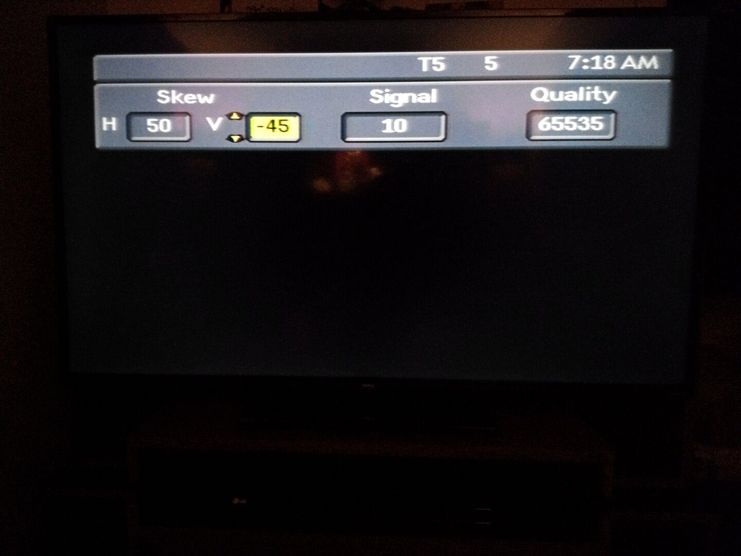

Here are the results with the skew at -45/40, -90/90 and 0:
DSR905 LNB1: -45 Results: 8 Transponders/56 Channels
DSR905 LNB1: 45 Results: 9 Transponders/46 Channels
DSR905 LNB1: -90 Results: 12 Transponders/56 Channels
DSR905 LNB1: 90 Results: 12 Transponders/66 Channels
DSR905 LNB1: 0 Results: 10 Transponders/56 Channels

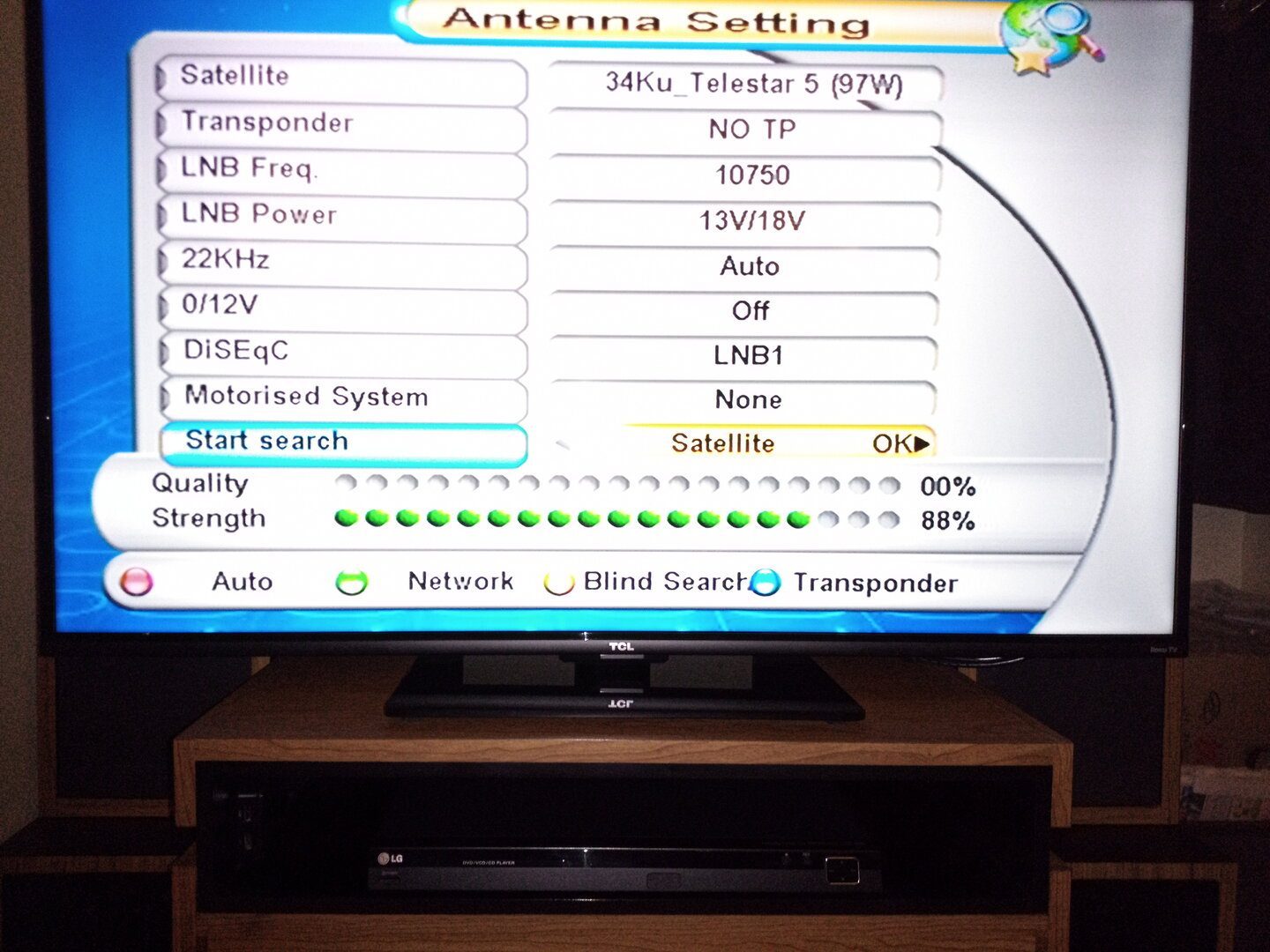

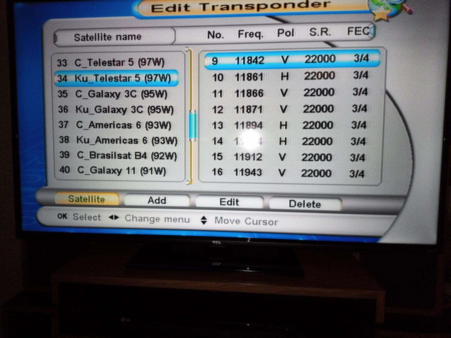

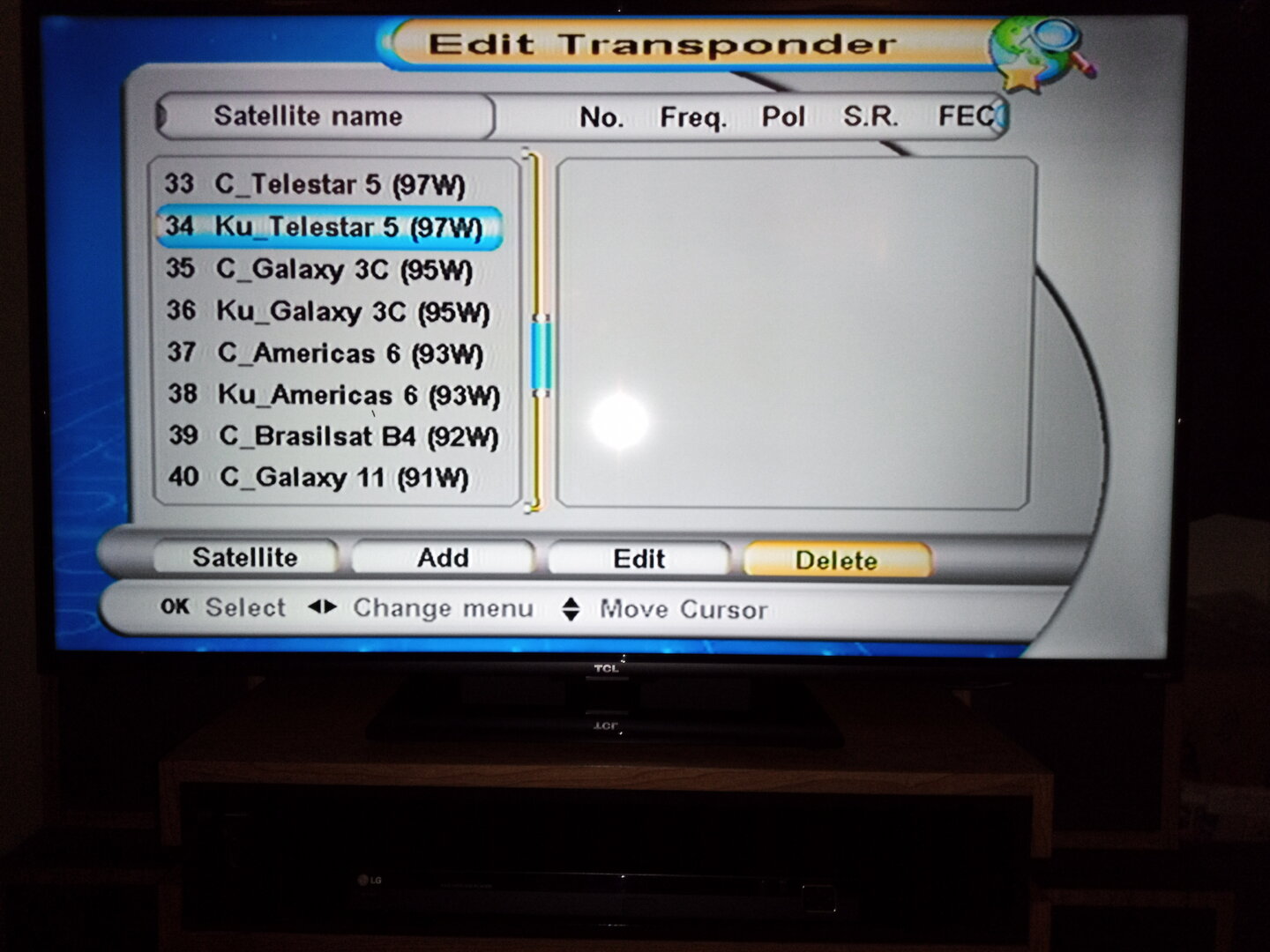

Another strange development. I decided to change the LNB setting in the DiSEqC CW to LNB2 and got over 80 transponders, is that even possible ? ...LoL
I will try with re-scan on LNB2 at -45/45 and -90/90 and 0 tonight
DSR905 LNB2: 90 Results: 80 Transponders/66 Channels

Is the above screen from the Drake, or the CW?
If from the Drake you should change the H skew from 50 to 0 and the V to 90 and do a scan (after deleting all transponders/channels) and then give a list of the transponders that come in.
As far as LNB2, I have no idea what is going on there, do you even have an LNB2?
The screen is from the CW.
I will try to see what is in the Drake's LNB settings.
I guess the two LNBs is one for C-Band and the other for Ku-Band, not sure if that comes into play.
The skew screen is from the DSR905 and the others are from the CW.
OK, and to clarify, was it this screen in the DSR905 where you were changing the skew (polarity)?
If so, and it is still connected to your system, change the H to 0 and the V to 90 and re-scan. Then post a list of what transponders are scanned in.
Great idea, yes that is the skew in the DSR905. I will try to change the H to 0 and the V to 90 and re-scan and get back to you here. Been tided up this week and will try it once I get some time this weekend.

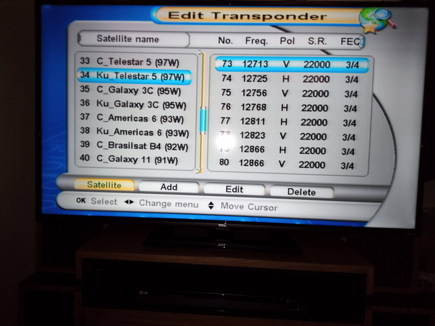

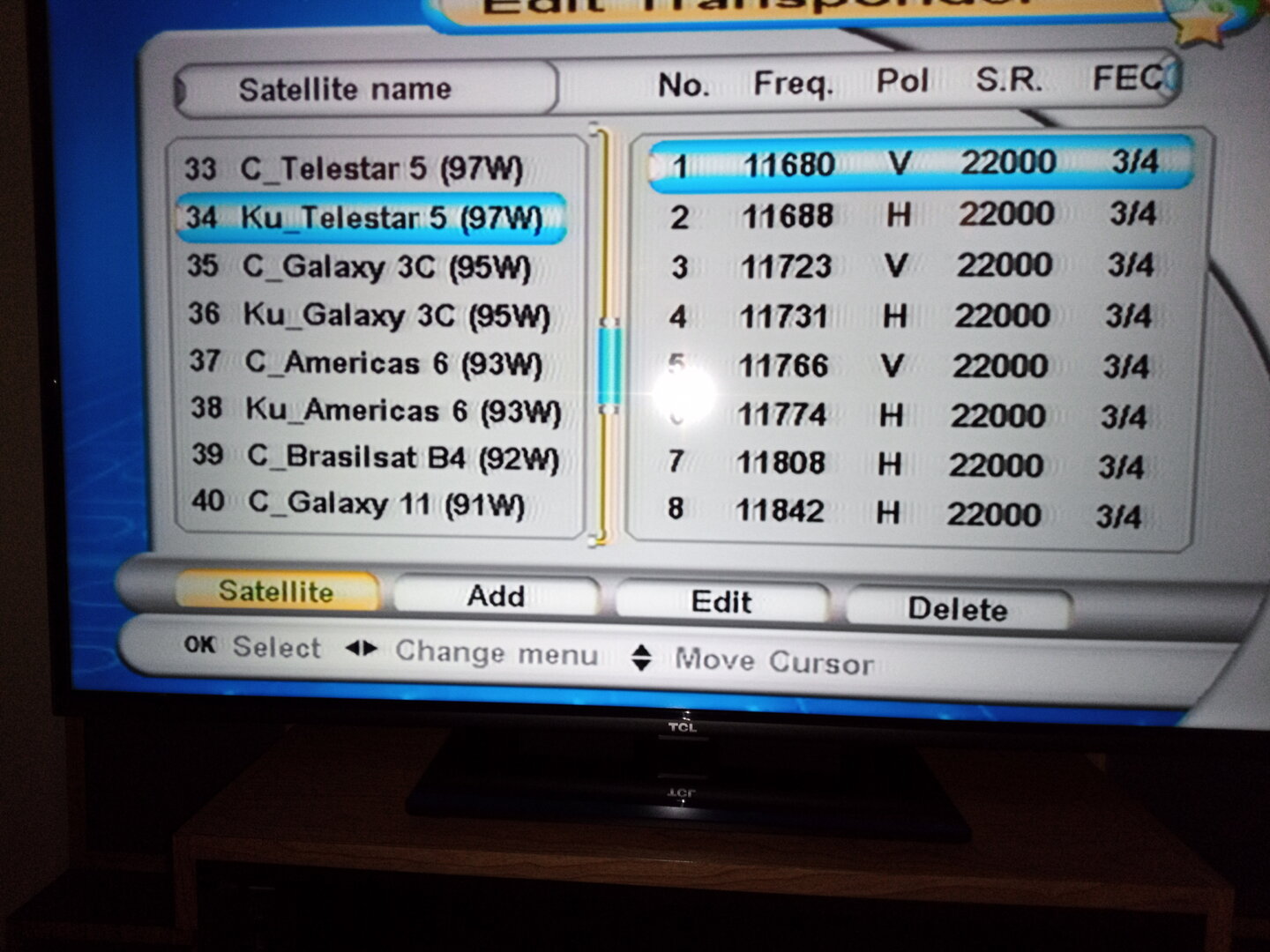

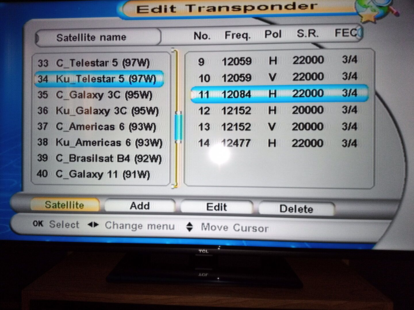

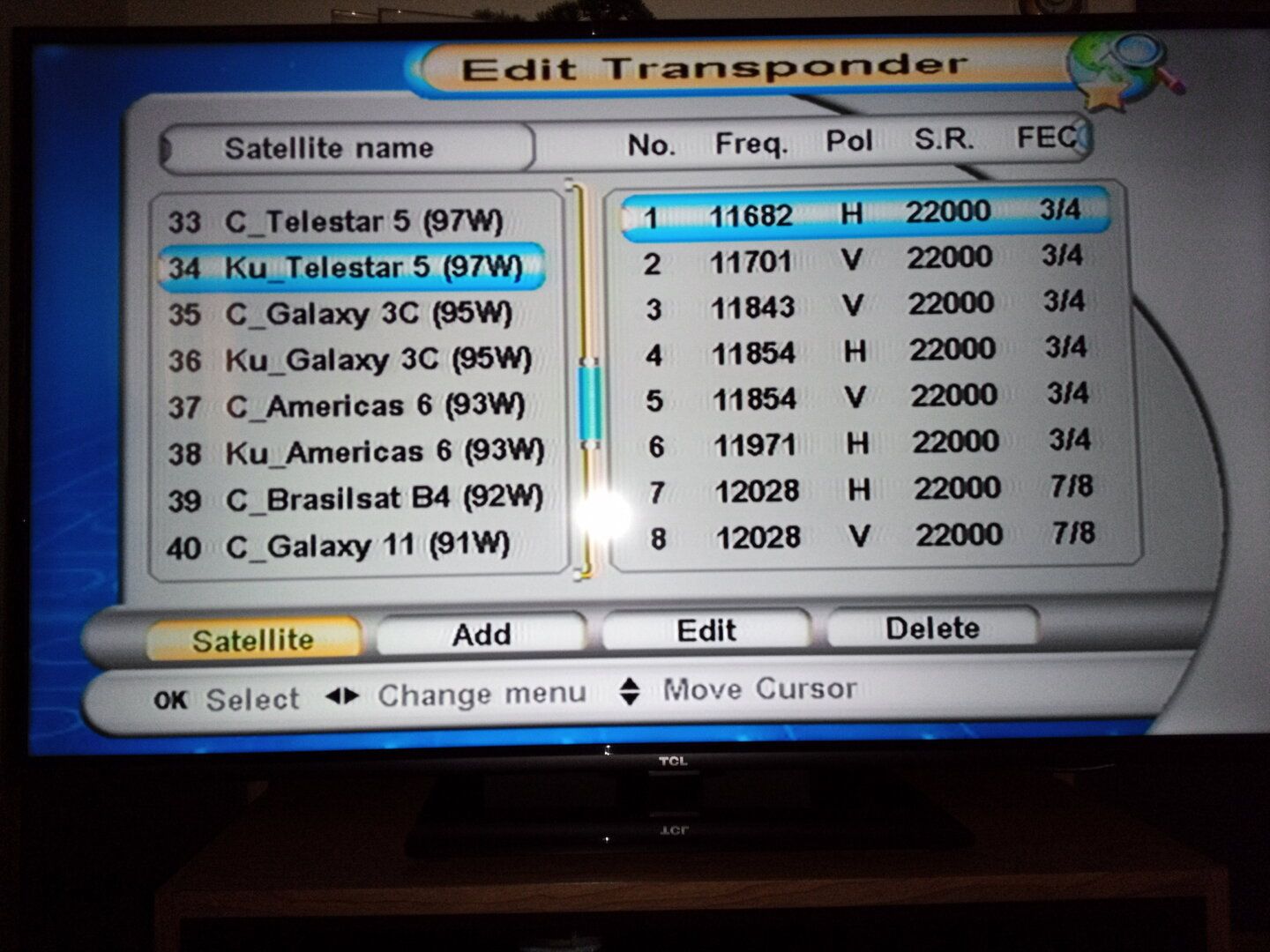

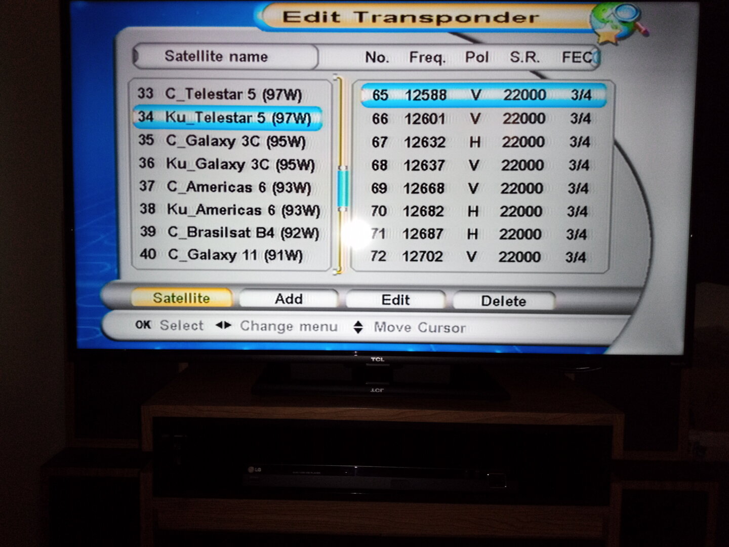

Okay had a chance to try your suggestion and the good news news is that I was able to capture transponder 12084H in the skew H:0 V:90 the first time, but it was not repeatable when I Blind Scan it again the second time around. Here are the results:
Drake: Ku Band
DSR950: Skew: H:0 V:90
Results: 66 Channels/14 Transponders <-- 12084H was detected, but no sadly no 12084V
Drake: Ku Band
DSR950: Skew: H:0 V:45
Results: 36 Channels/6 Transponders
Drake: Ku Band
DSR950: Skew: H:0 V:0
Results: 76 Channels/12 Transponders
Drake: Ku Band
DSR950: Skew: H:0 V:-45
Results: 56 Channels/10 Transponders
Drake: Ku Band
DSR950: Skew: H:0 V:-90
Reactions: Keith Brannen
It still appears that you are only scanning in Horizontal transponders as both H and V (12028, 12058 and 12152) as well as some that are not 97w (at least, not with those numbers). What channels show up if you manually scan 11682, 11701, 11843, 11854, 11971, 12084 (if it shows up again), and 12477? You don't have to give all channels that show up, just two or three for each transponder (if any scan in) so we can determine which are valid for a different transponder, or if there is a system problem.
