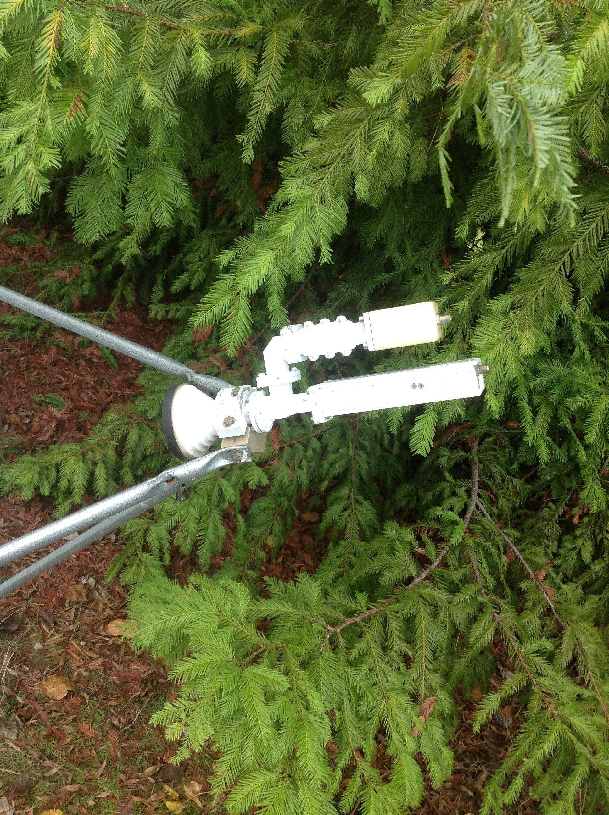

Here is a picture of the one I have. The LNB on top is the KU LNB and I was going to pull the lower one and just put a single C band LNB on it, but got distracted with a C band dish.
that feed horn is quite different than the small one on my channel master dishes.

Commercial dish off a gas station. Great dish to lock in any KU satellite.
