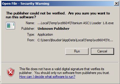

I also tested the linked file on the Titanium Satellite website. The link works fine and the folder downloads and unzips without any problems on a WIN8 laptop using Firefox 34.0.05, WinZip with full AVG antivirus enabled. There must be a security issue with your PCs.:(
Click OK if you see this or a similar security warning.
