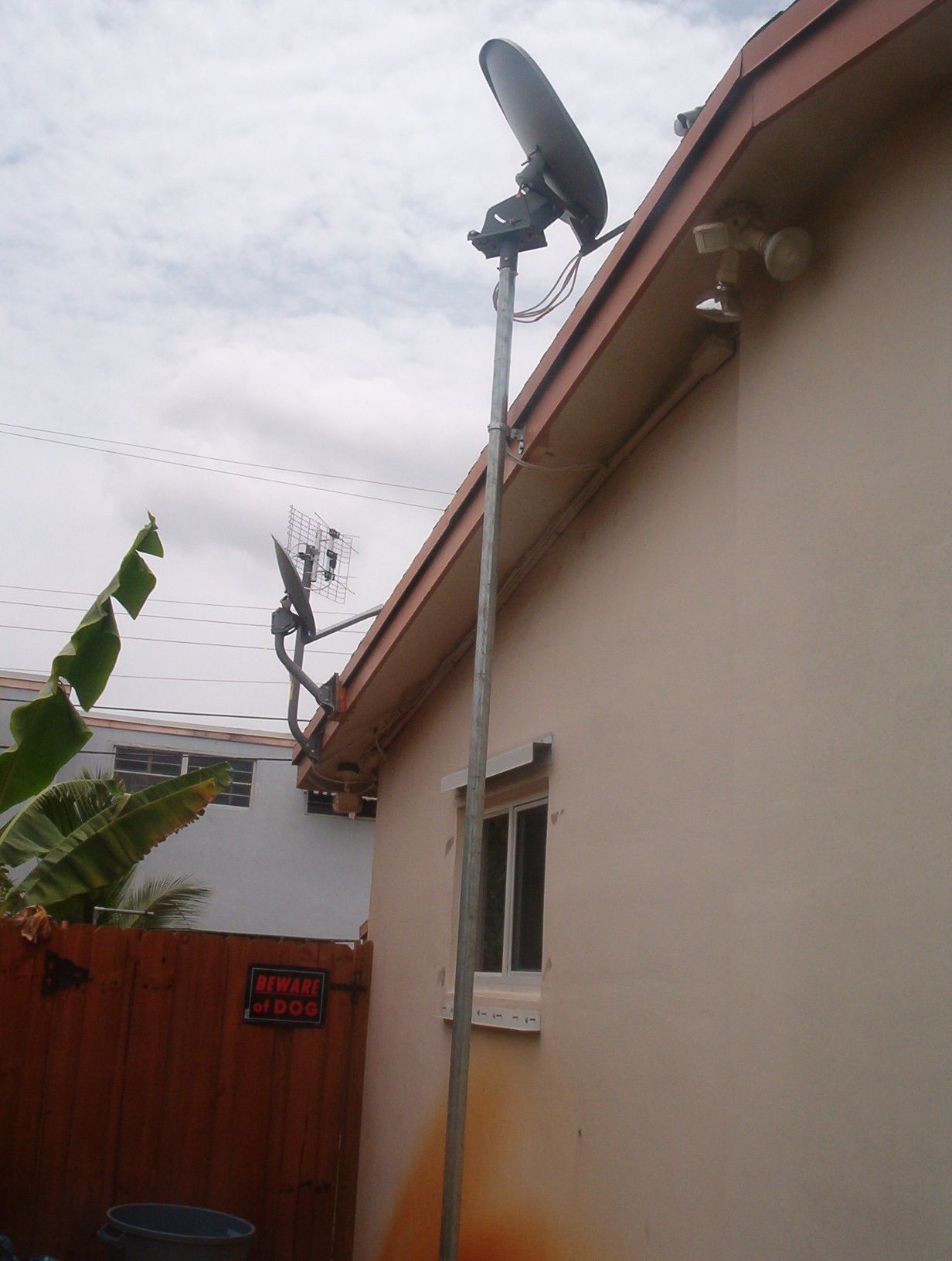

Here you go! If you need one closer up let me know.

The installer just got here. He told me the 5LNB couldn't be installed on my eave or my roof - he told me it could only be installed on a flat roof ? How many people flat roof's ? I then pointed to the pole I installed ( right next to my existing dish ) ( apparently he didn't notice the 15' Pole ) and he said he would have to check with his office to see if he can install it on the pole. It seems like he didn't want to do the install ? Good news - He's installing it now. Good thing I put the pole up !!! will post pics when he's finished -:cool:

The installer just left. I don't know if he should have used support arms with a pole mount, but he didn't. He also couldn't secure the dish tightly to the pole because he ran out of self tapping screws, so I had to tap it out and put a 1/4" bolt in. but its finished ! I find it hard to believe that the new dish can only be installed on flat roofs, I did see one installed on a fascia board ( with no support arms ) - That cant be good, especially down here in south Florida. Oh well -:eek:

I had to get the pole. I had a hard time finding one long enough - finally found one at a sprinkler supply store. The installer told me they don't install the AT9 on fascia boards - but i have seen them around. My old 3LNB dish was installed on my fascia board ( with tapcon screws ) so i had to "beef" it up before last years hurricanes. The installer would have mounted it to the south side of my house on the concrete wall if not for my neighbors trees, probally better option than the pole mount. my Pole is 14' long set in 150lbs of concrete and attached to the fascia board with lag screws and bolts, It's extremely solid so i don't think it's going anywhere.:hatsoff:

Looks like an excellent install to me. I'm glad you found the pole, it's the best way to go, imnsho. ;)
