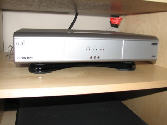

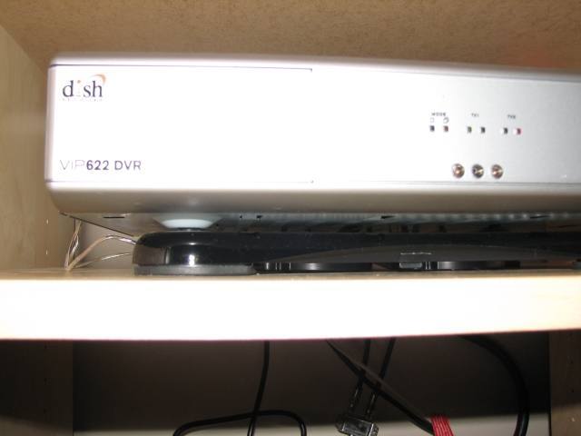

Here is my solution to keep the 622 cool. Staples has a promotion on it's Antec laptop cooler (USB operated). I got mine for $5 today (had a $10 gift certificate) after instant savings of $10 and a $15 rebate. Here is the link:
http://www.staples.com/webapp/wcs/stores/servlet/StaplesProductDisplay?catalogId=10051&productId=101316&cmArea=SEARCH&prodCatType=1&langId=-1&storeId=10001&krypto=mfxq1nTSMWh0shUQOLdqejr6zGQ2Y8NL
I have my 622 on top of it. Can't even hear the fans and I have it on high (low/high setting). Here is what it looks like:

coolbreeze said:
Guys,
Does that work? What are your temp reading before and after using that? I raised mine up with some water bottle caps under each corner and it dropped the Avg. temp 2º to 116º. And Mark_AR, how did you manage an avg. 82º?
