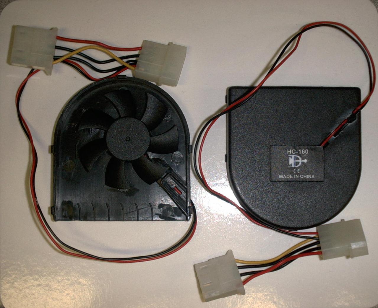

I found in my junk box two thin fans - 7/16"; I recal it's came from some PC where are they cooled HDDs.

Hey bhelms, did you manage your time for check that clerance ? Will those 7/16" fans fits ?
Sorry, P. Smith - I have not! My bad...! I see that open unit every day with the IR and TC temp measuring devices sitting on top of the fans waiting for me to continue my experiments and I curse myself for bad follow-through! Your request is not forgotten - I will at least check the clearance this weekend and report back on Monday (wrote myself a reminder note). Again - you want to know the clearance between the top of the HDD mount and the inside of the cover, is that correct? I think it's less than 7/16" (maybe 1/4"?) but I will confirm.

P. Smith - I measured the clearance this weekend. From the plane that is the top of the HDD/fan mounting bracket (most of its surface area) to the plane that would be the underside of the cover there is about 0.275" clearance, maybe a bit more. Of course this is approximate and it does vary over the area in question (especially at the stiffening "bumps" in the bracket between the HDD and fan) due to irregularities in the flatness of the bracket.
