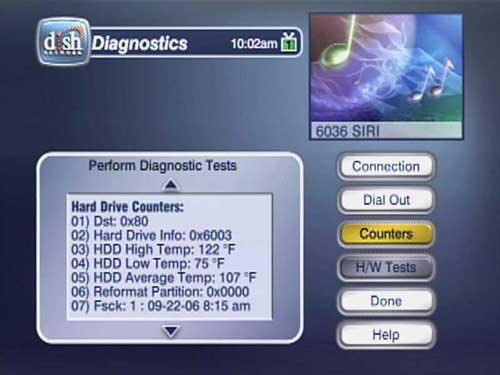

Go to Menu, 6, 3, Counters and then Page Down three times. These are just the hard drive temps. and it will look like this:
