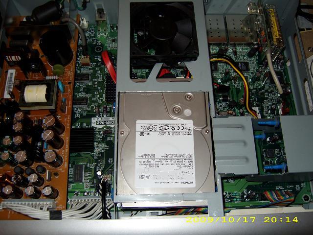

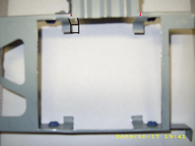

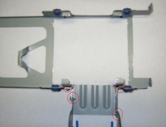

Additional mod to my original one with big fan
Decide go further and made a big cut at top of HDD/fan holder.
It should help increase airflow on top [hot] surface of the disk.
If someone will follow, be sure you make right cuts for two flaps (those four flaps are for holding the disk underneath) - I messed up with one, it should be in position what I marked by black lines, so short original notches ( marked by red ) should point into middle of those two flaps on top the picture.
Unfortunately, original holder doesn't have vertical connection from fan's tunnel to main part what holding HDD, so after the mod it become flimsy. For reinforce it I added two right angled strips (what was leftovers after top cut) hold by four self-tapped screws ( marked by red on second picture).
Last picture shows assembled back 622 with modded holder, fan and HDD.
