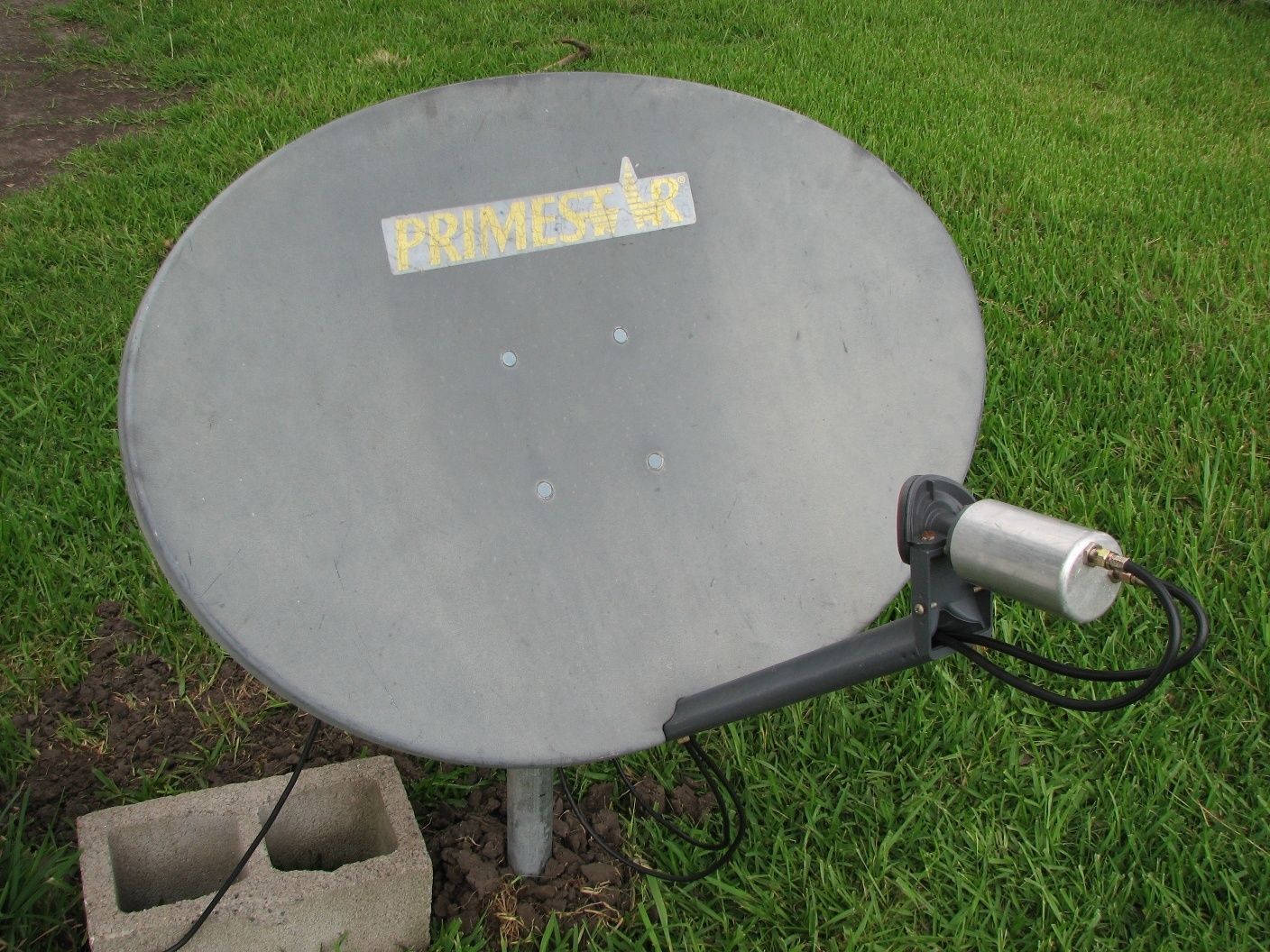

edit: Oh and here's a pic of the latest little ugly stepchild to take root in my backyard. :rolleyes: I guess I should be happy my house faces North. These things would be horrible in my front yard. :eek:
Dee you'll have to call that one Stubby, haha. That's the shortest pole I've seen a dish on.
It's a great dish though, got 2 of them. One is not hooked up right now, the other is pointed at
AMC5 for the horse races. Very good gain on those 84e dishes.
