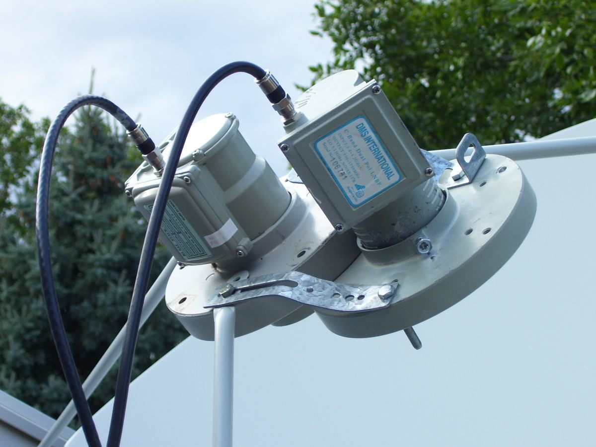

I havent had one hooked up recently but the "flat" edge where the coax is should be at 0 degrees...flat should be horizontal
in the pic below the LNB (left one) is near 0 skew
