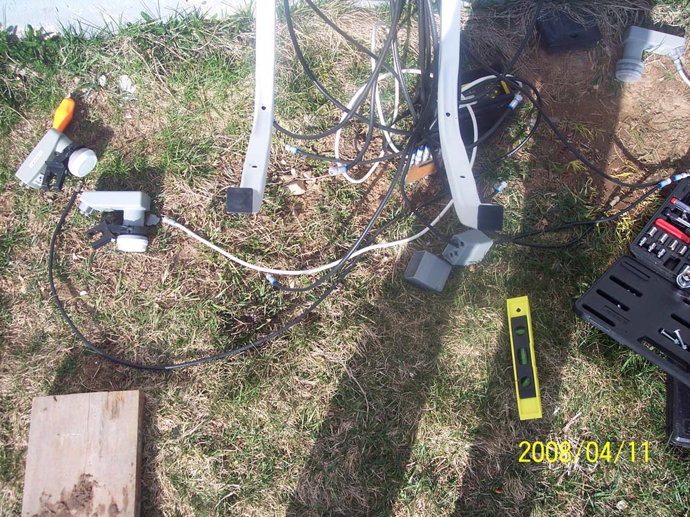

My T90 fell last fall in a hurricane. I set it up again since but I haven't been really happy with the signal levels since. It's been cold so I haven't played with it until the last few days again.
The secondary reflector is out of level when placing a level across the two front supports, even when the mast is plumb. When it fell it landed on the right side of the secondary reflector. I question the main reflector's condition as well but the secondary supports are out of alignment. The right support is out by 3/8" from the left. Neither support shows any sign of stress cracks in paint finish or bulging due to being bent.
My BEV sub doesn't notice any signal problems but any FTA sats are around 25-35 on my Viewsat's meter and 35-45 on my Twinhan which is MUCH lower than they used to be.
My question is, which support arm on the secondary reflector should be straightened or should I bother?
Where the support arms are vertical at two places (top of the end where the secondary reflector attaches and after coming out from behind the main reflector) is there a specific distance between those two vertical sections that I could tell just how bent one or both of the supports are, or aren't?
As you can see, the supports don't quite line up with each other when looking down over top of them.

Ask someone on this forum who has an unassembled T90 to trace the secondary reflector bracket onto a piece of cardboard, and then mail you the cardboard. Or if you are sure the second bracket is not bent, then you could straighten the bent one to match the good one.
If the reflectors are bent, time to shop for a new dish.
The secondary reflector doesn't look bent. I'm going to lay the main one down on the floor and see if it might be clamshelled one way or another.
I'm only making what I would call an educated guess, but I'd imagine that the support on the left is fine. I say that because the sats in the lower orbital slots always give me a higher SQ than higher ones on the dish.
If that is the case I could trace both (just in case I get it backwards) mark which one was on what side. Then bend the one on the right to the same shape as the one on the left.
Does this seem reasonable?

First off, I got the dish straightened out. I bent the right arm to look like the left. I also un-clamshelled the main reflector. And bam! SQ on the Viewsat doubled on everything. The birdog shows VBERs of 0 on most lnbs now.

I laid it down flat on my livingroom floor. If I pushed down on it on one side, it would wobble back and forth.
I took my fingers around the rim of the dish until I felt a bend (it landed on it's side last fall) and bent it to match the areas before the bend. Soon as I did, it wouldn't wobble on the floor anymore.
