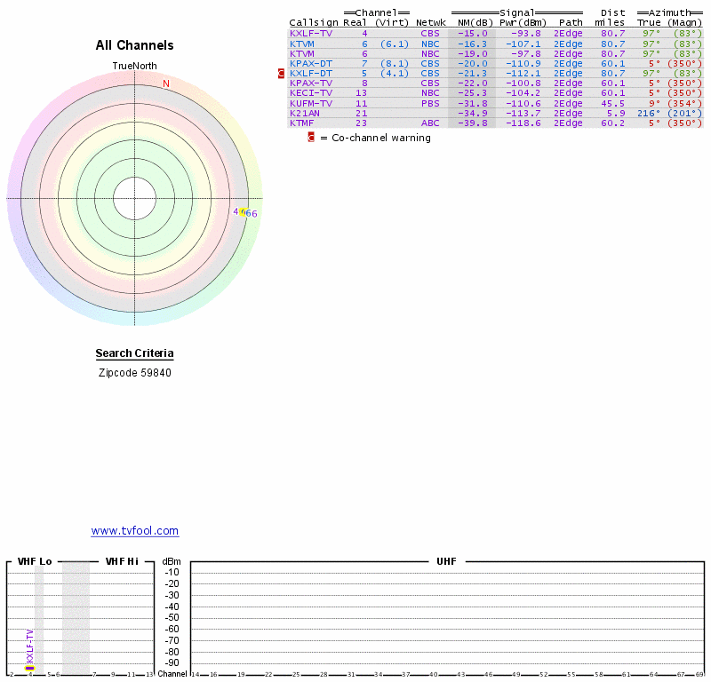

I just purchased a Clearstream 4 antenna and installed it in my attic and the picture was even worse then the cheap radio shack antenna already up there. I live in a subdivision where antenna's can not be placed on the roofs. I realize that legally they probably do not have a leg to stand on but as I stated in my earlier post I just want to keep the peace. I would like to receive my local channels that are 50 miles and all in the same direction. The antenna will have to be in my attic and it would be 35 feet high. What would be the best antenna for this situation if money is no object .
I am using rg-6 cable and only need to go to 1 t.v. also tvfool doesn't list 2 stations that i know are availible. the length from antenna to t.v. is about 100 ft.

If that is the report for your exact location, even the best outdoor mounted antenna would be a long shot with those signal strengths, and obstructions. Did you run TV FOOL with your address or geographic coordinates?

With that TVFool report you will likely never get reliable signal in the attic.
I ran TVFool reports for your zipcode with elevation up to 200 ft. - tough situation.
Since all signals are VHF - go with the Winegard 8200 and the AP 8275 pre-amp.
May not get you stable signal in daytime.
Mount it as high as possible - I recommend a 200 ft tower, but that is not practical, so go as high as possible.
Right now pretty much everything you can get is VHF, and an attic mount probably won't cut it. You'd probably want one of the big Winegards that also grab low VHF (especially if you'll still have some low VHF after the transition). The 8200/8275 combination previously mentioned is probably one of the best combinations in your case. The 8200U has slightly better gain on most of VHF but the specs show the 7084 is a little better on Channel 6 which one of the stations he'll be aiming for.
