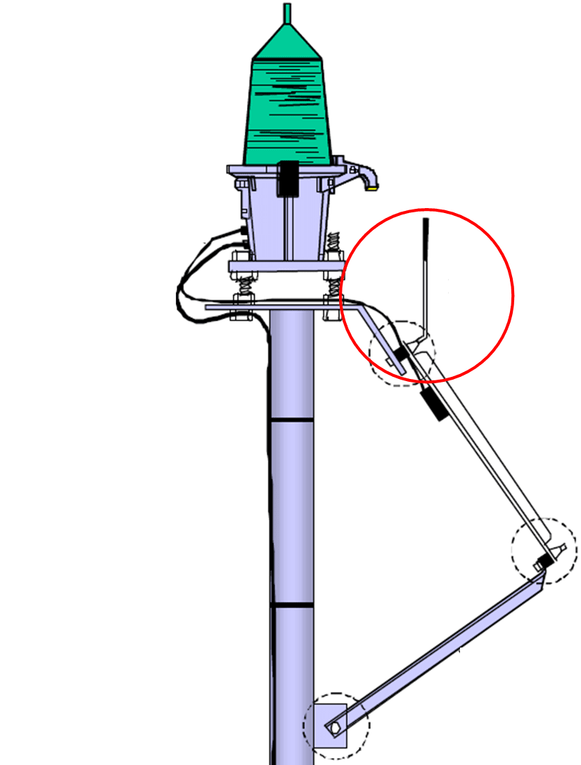

In my line of work - maintaining aids to navigation (aka channel markers) for maritime traffic - we have to deal with the after-effects (guano) of roosting birds quite a bit.
Most of the lanterns have a conical top that prevents roosting. Our biggest issue has to do with solar panels that are mounted at about 45º towards the south. The solar panels have mounting bolts at the corners; over the top of the exposed bolts (head on underside, threads and nut towards the sky) we attach bird springs. These are nothing more than ~16" coiled springs that waggle around and discourage roosting. They help, but are not foolproof. I can't tell you how many times I have pulled up to a light to see a bird standing on the springs! :D
We also use a similar system for horizontally mounted solar panels on buoys.
I have attached a diagram to illustrate (spring is bent to vertical in diagram, at top of solar panel).
You may be able to come up with something similar for the top of your dish.

Thanks RedSavina, That's an interesting thumbnail. Since Glorystar tended to categorize the bird dropping problem as minimal, I'll probably {try} to ignore the droppings.
