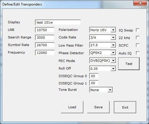

hey, sorry to revive such an old thread, but i just got the satedit prog and am having a problem.
my birdog works great with the files from the birdog site, but when i create a file with satedit and transfer it to my birdog, it will lock for just a second or two and then the signal drops out (with the dish peaked on 101w and stationary)
at first i tried it in linux with wine and thought that might be the problem, but i tried it on a win xp box with the same results.
my settings in the define tp box,
lnb - 10750
search range - 3000
symbol rate - 26700
frequency - 12060
polarization - h 18v
code rate - 3/4
low pass filter - 27.5
phase detector - QSPK2
fec mode - dvb (QSPK)
roll off - 0.35
diseqc group 0 - 00
diseqc group 1 - 00
tone burst - none
i have tried it with iq swap both on and off
i then add it to a list, and then send it to the meter
anyone see anything wrong?
it has me stumped.
thanks for any help,
Denny
this is weird,
every other transponder on this sat and a few others i've tried works great, but for some reason it will not keep a lock on 101w 12060 h
is it still 26700 sr 3/4 fec?
or has it changed?

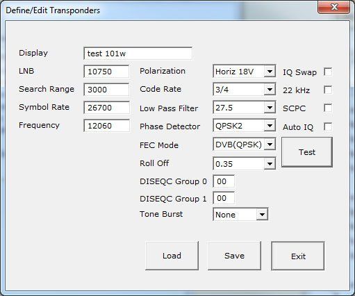

I just tried those settings and I can lock the signal no problem with my Birdog V3 USB.
