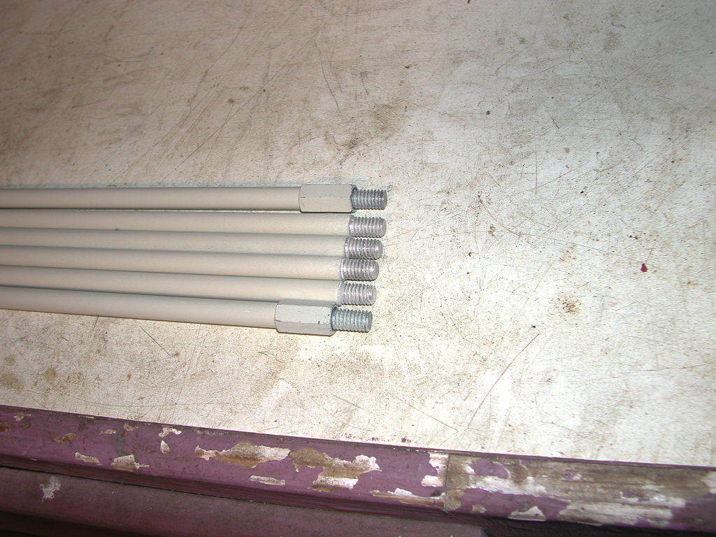

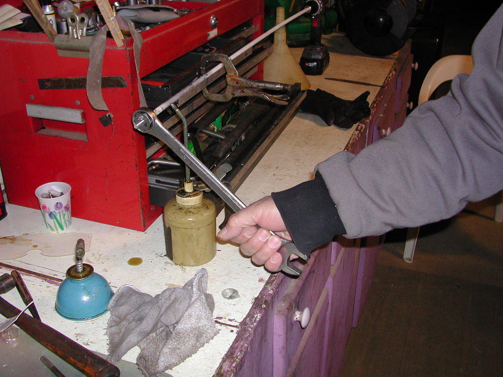

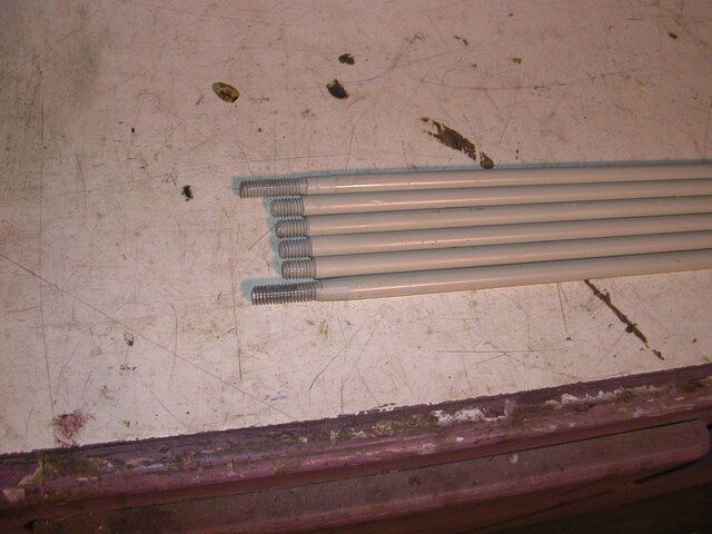

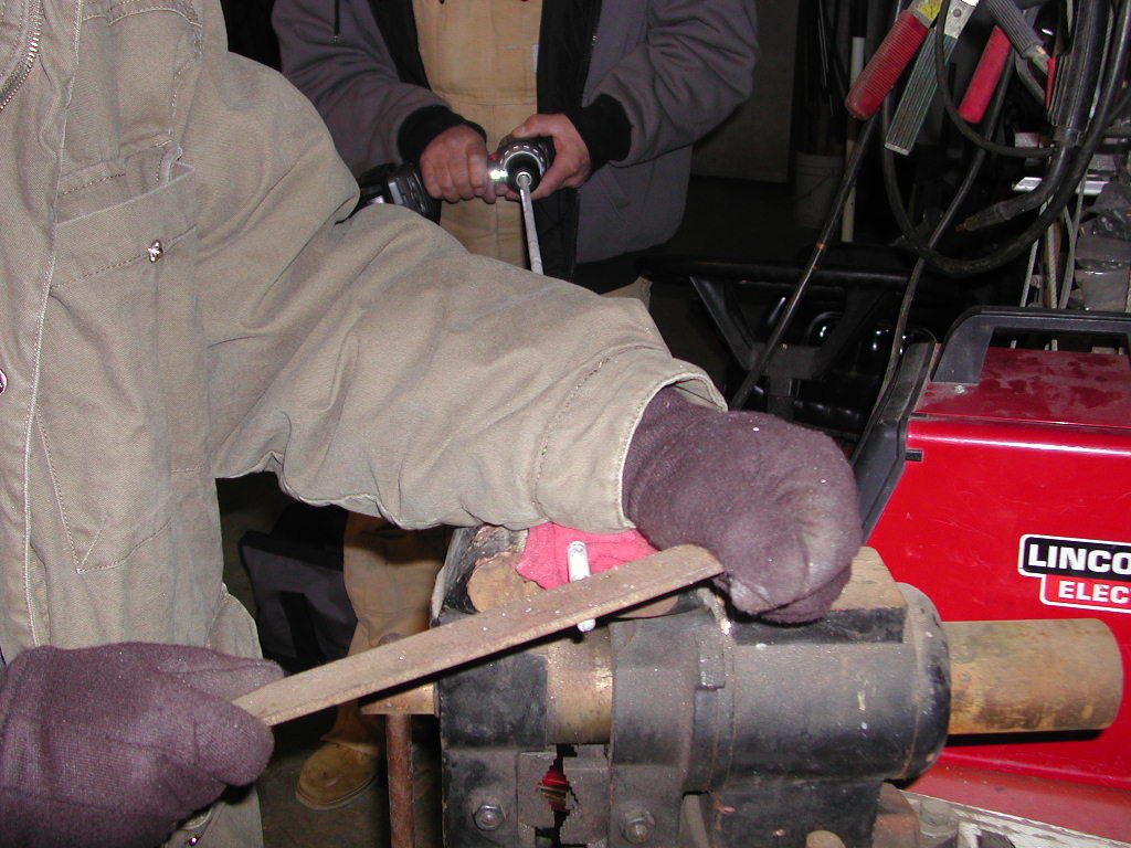

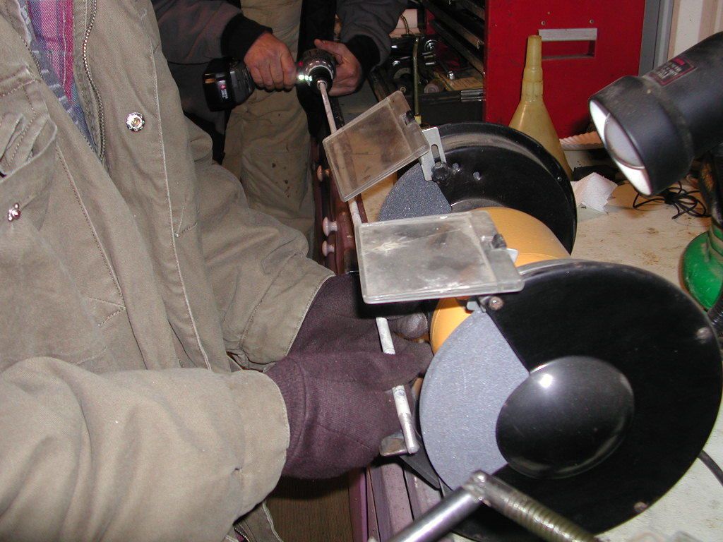

Here is some pics of how I added some threads and added some thread extensions that linuxman gave me. As Stogie mentioned you could use all thread for some, or all of the arm, also. :)

Thanks Guys, they have been broken off at both ends, so I think that stainless all thread is what I am going to use. I will let you know how this turns out. The overall length of these are 42 inches including the threads. Thanks again...
