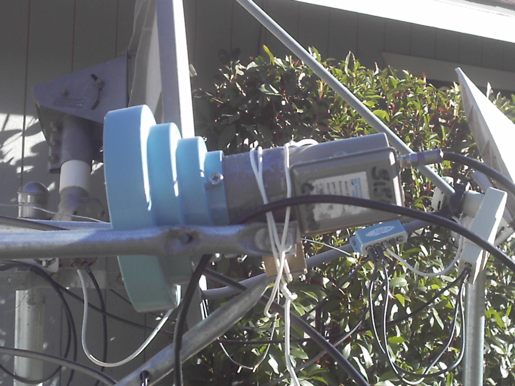

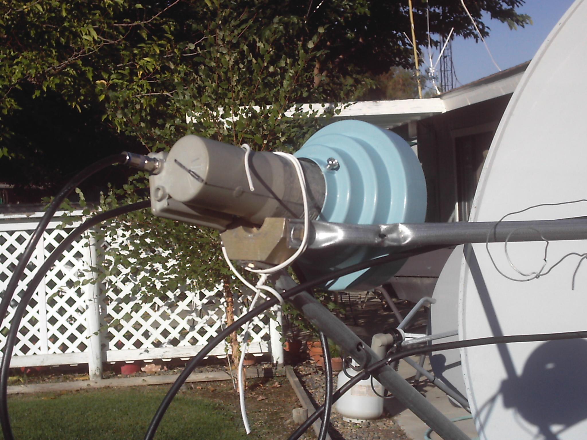

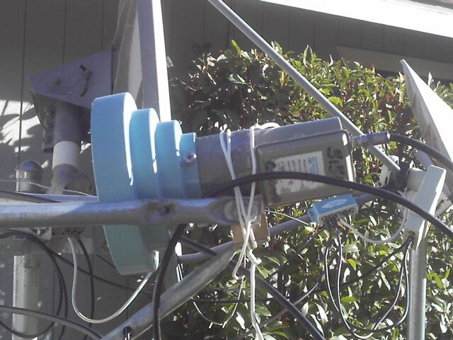

I did not try the 3ft, but I did do the 4ft (1.2Meter). I locked it on 91W for KU Band first then swapped the LNB out for C-Band.
It took a lot of time and a lot of tweaking using a professional sat meter (SuperBuddy 29), but I have 91W C-Band locked. CW, FMC, etc.
It's ugly since it is temporary, but it works fine.
