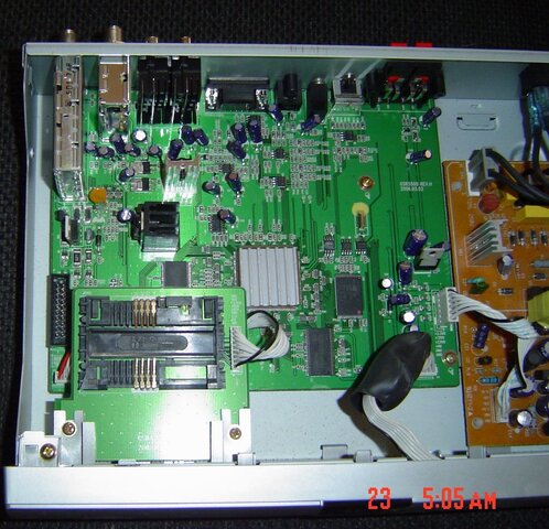

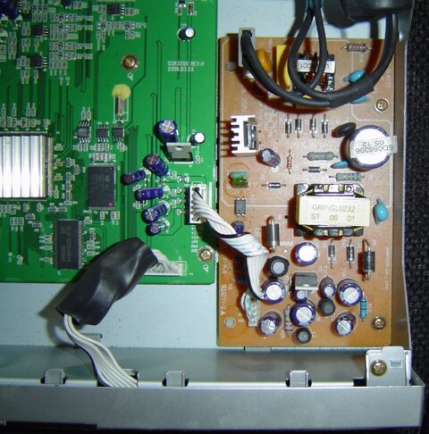

I just looked at the caps C13 and C14, and the tops are pushed up just a little. The cross-lines are expanded and not nice and tight like C19, C12, and C20.
Also SatinKzo, it does have a nice 20 pin IDE like connector on the inside.
Here are some pics.
Tell me if you can see everything ok.
Fred
Thanks for the images, It looks like you have the slot for the JTAG header " 20 pin IDE" already there ,could you please get a side view of the capacitors? or something like a 45 degrees angle to them.
Thanks.
Well, if your caps are good, it's an easy path to jtag, but need to see more with the caps. Can you take a side pic? Also, just incase, can you take a close up of the chip to the right of the silver heatsink in pic 2. That chip tells me what jtag file you would need.
