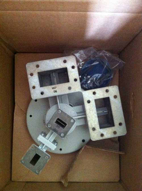

sure pls check the pics.
I'm pretty sure there will be a way to set up this rig once you have us educated on every aspect of the project LOL and we understand what we are doing here. It may not be simple like we want but we can make it work. Maybe you could PM me about possible purchase of a normal Bullseye II. I'm really curious to learn more about the feed you have.
pls see this pic.

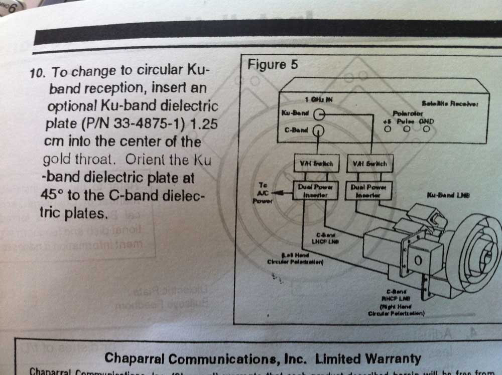

on the installation instructions its like they are using two separate port receiver for KU and C. Are there any receivers like that out there?

What I want to do is connect everything ( all 4 ports from LNB's on Bulls Eye II Wideband ) to a single receiver using a switch. First I thought this is straightforward thing using a DiSEqC switch I can be wrong I am not sure?
since there are few different things that I am not familiar such as Universal KU 22kHz tone passing through switch and power inserts and stuff I m really clueless on what to do to get the above setup up and running.
The over-simplified solution is to use a 4x1 DiSEqC 1.0 switch. One port to each of the four LNBs. Then you write four satellite lists for every location. One for each polarity, using tone switch for the wideband KU lof switching.
