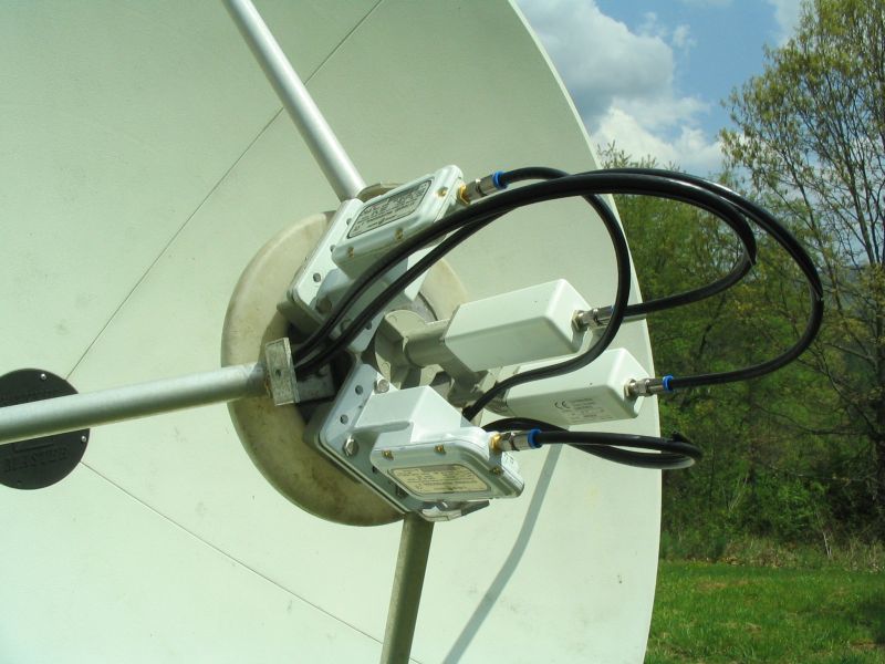

There could be 2 different problems. First, C band LNB's will sometimes balk at the 13-14 volts they are fed for operating voltage and simply refuse to work. Power inserters were discussed earlier in the thread and would be required to fix this problem. Second, with a Bullseye it is possible to have the KU LNB's oriented exactly backwards which would prevent any KU reception. Loosening the hex set screw and rotating the flanges 90 degrees would fix this problem if it exists...
Here is a pic of the way mine is oriented when the dish is down to the West...

Just make sure the C band LNB's are in the 22khz off ports of the switch and the KU LNB's are in the 22khz ON ports, and make sure the LNB settings in the receiver reflect this....
When the feed is oriented in the way I have mine, when the dish is up at due south, the top most C band LNB will be vertical and the LNB on the left side will be horizontal. For KU the center LNB will be vertical and the bottom LNB will be horizontal.
