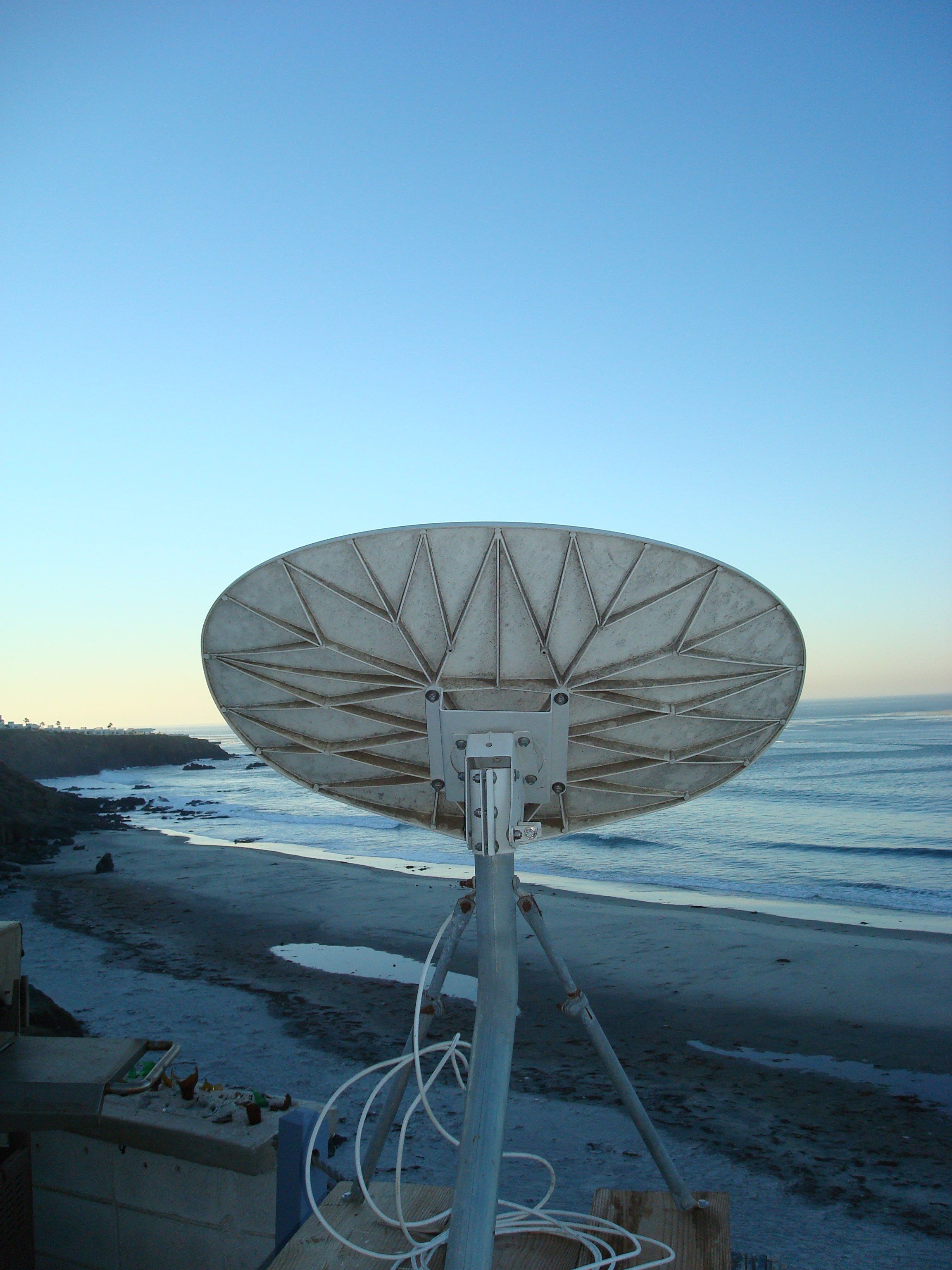

Finished the I/O card swap and updated the dog so far today. Thought I'd post the pics of my temporary set-up as well as the lousy LOS I'm working with - this shows the LOS on the 110 bird.

Wow, that's some serious LOS!!! :eek:
Thanks for the pic, my mount is different than yours, it is even heavier, I'll post a pic when I get my camera cured. Sounds like you are making progress.....:cool:

Uh, beautiful pic, if you'd move that dish out of the way it would be perfect!........lol j/k.

great pic
That would've been a nice wallpaper shot for my computer!
Hey that dish is exactly like one I have, yes its a standard linear lnbf, LO of 10750 and will do both polarities. Just skew the dish correctly for 123 and should be able to get it fine. Beautiful view there.
After actually looking at the subject of the pic it occured to me he set the skew as a cauculated value and it has yet to be verified as correct. It's is possible that tweaking the skew may net an improvement.
I'm with you on the wallpaper turbosat. Beautiful. Maybe our new comrade in arms Baja Mike will shoot a few custom shots for us.
Mike, looks like you got the sandy beach and all your neighbors to the south are cliffside.
