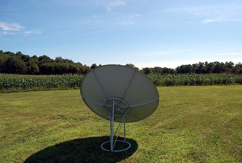

I have been having issues with IA6 analog. Just can't seem to get a picture without static-a couple times I had a good picture but no clean sound. My concern is about line of sight-there are some trees around my yard. The weather was perfect today-low humidity and no chance of rain. So, I loaded my six-footer into my truck and made the short trip up the road to my little piece of land. My mother in law lives there now but I hope to move there someday if I outlive her. ;)
Anyway, I ruled out LOS issues! I am getting the same quality on G4 nets as always-59 spiking to 66 occasionally. Found G11-70 % + on EWTN and analog picture and sound perfect (ABC soap opera). IA6-same thing as before-can't get a consistent analog station. I saw a slate too so I know I was on it. I also hit AMC3 analog (saw slate).
Any ideas if this is normal?
BTW, how do you like the LOS on my property? :)

IA 6 analog has gotten weaker for me too. It started last week and was real noticable during the Astros game. I used to get all vertical channels better than horizontal except for Tr 24 which is the strongest of them all. I get Trans 7 good on the old videcypher on vertical and Tr 24 comes in real strong still on horizontal. Tr 1 videocypher, Tr 5 lotteries, Tr 9 Tigers, Tr 11 and 17 are much weaker than before. I'm worried with the nfl preseason here. Tr 17 was okay for the Packers last week. I thought it was the placement of the ASClnbf thingamajig like it had moved. I played with that all weekend to get a better signal for IA 6. Nothing happened to improve it. I'm going to be putting the dish back on IA 6 later tonight from G4 for the games tomorrow. I'll see if the picture has improved at all.
Thanks Mike, it's good to know I am not the only one. Maybe that bird is weaker for some reason and with our six-footers it makes a difference.
