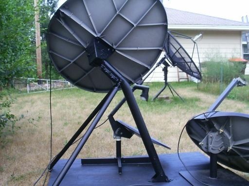

I was thinking of just mounting it on a pallate with the stand like they show on Sadoun's website (since this will likely not be a permanent installation) and weighting it down with a few blocks. Is it easier to "getto move" on a pole though?

My dish sits on a pallet loosely. I just move it around the pallet and try not to block the G11 ku dish. I don't have it mounted on the pallet, but I have a bag of sand should a wind storm come to weigh it down, but here in So Cal, that's rare compared to winds in Phoenix I used to see. I haven't weighed it down in the 3 1/2 months I've had it. It's easy to move as long as you have a TV nearby to see the feeds on the other birds. I look for analog on G11, IA 6 and G4, digital on AMC 1 and G3 if Geraldo isn't on.

There is a lot to be said for pallets and flat (roof/deck) mounts!
