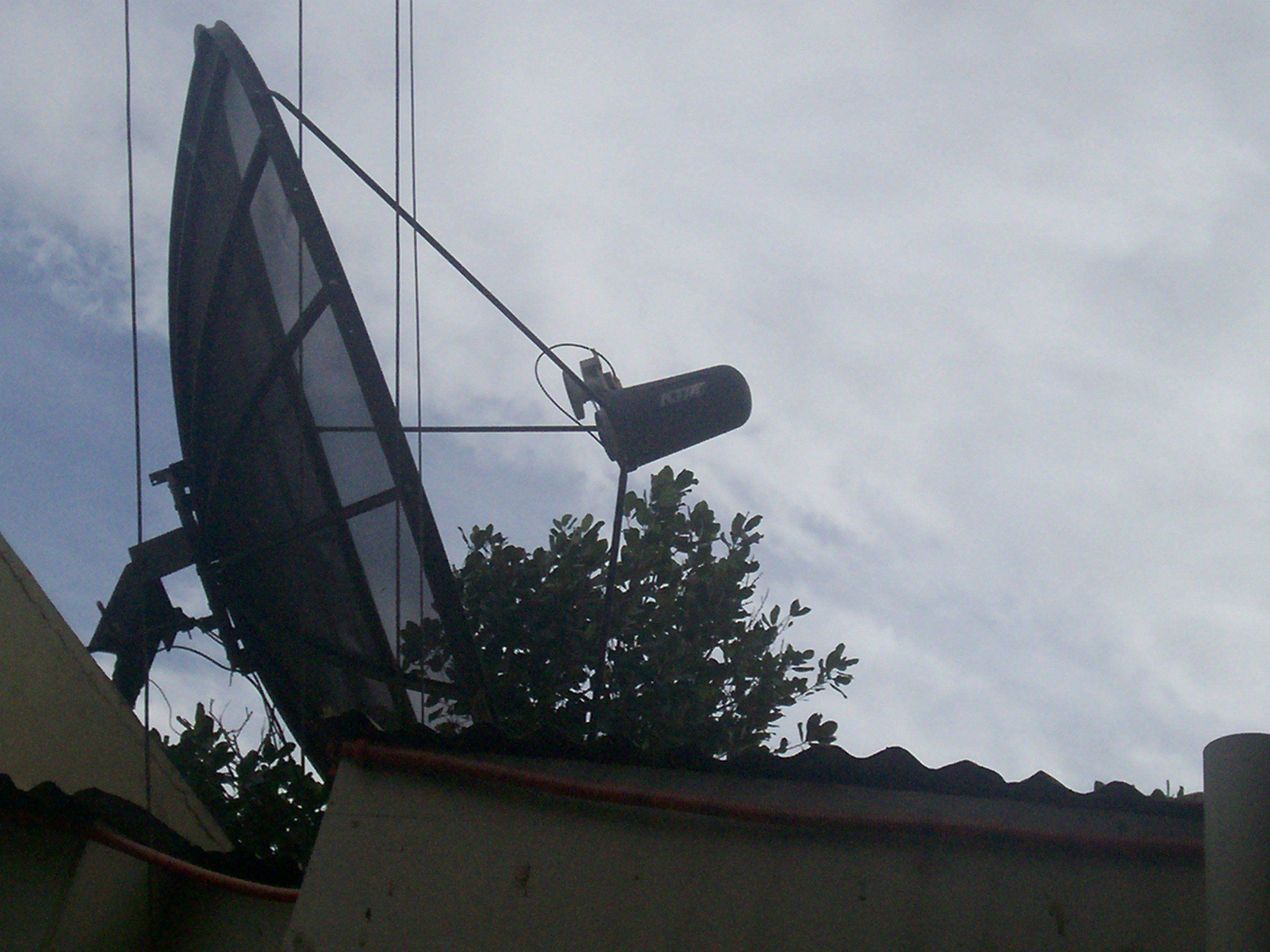

i want to ask some technical question regarding a multi-feed satellite dish.
presently i have a 10ft. sat dish (prime focus/mesh) receiving signals from telstar10 c-band, and i want also to receive signals from intelsat7/10 c-band.is it possible if i only add a set of lnb and a feedhorn to receive a two satellite signals with 8deg. difference in one sat dish?
my location: digos, philippines
6.7542deg north
125.356deg east

look up multi feeds on the c-band board. it should be possible to add just another lnbf beside your current one. several members have added a couple of lnbfs to a fixed dish to receive several satellites at once.

i got 2 satellite signals 1 sat dish.

Bravo Agers. Could we get a front view pic? Are the two sats Telstar 10 and PAS 7/10?

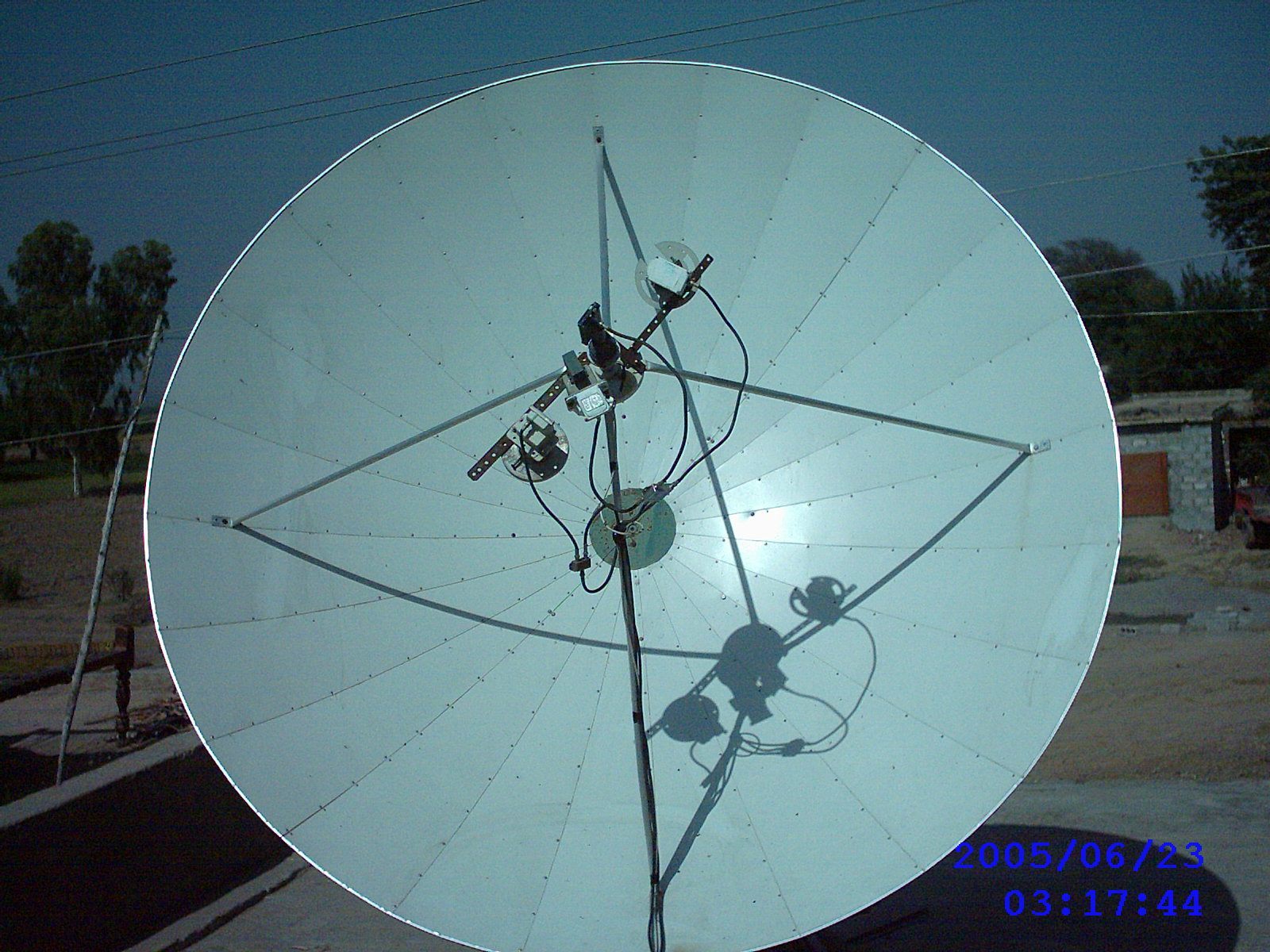

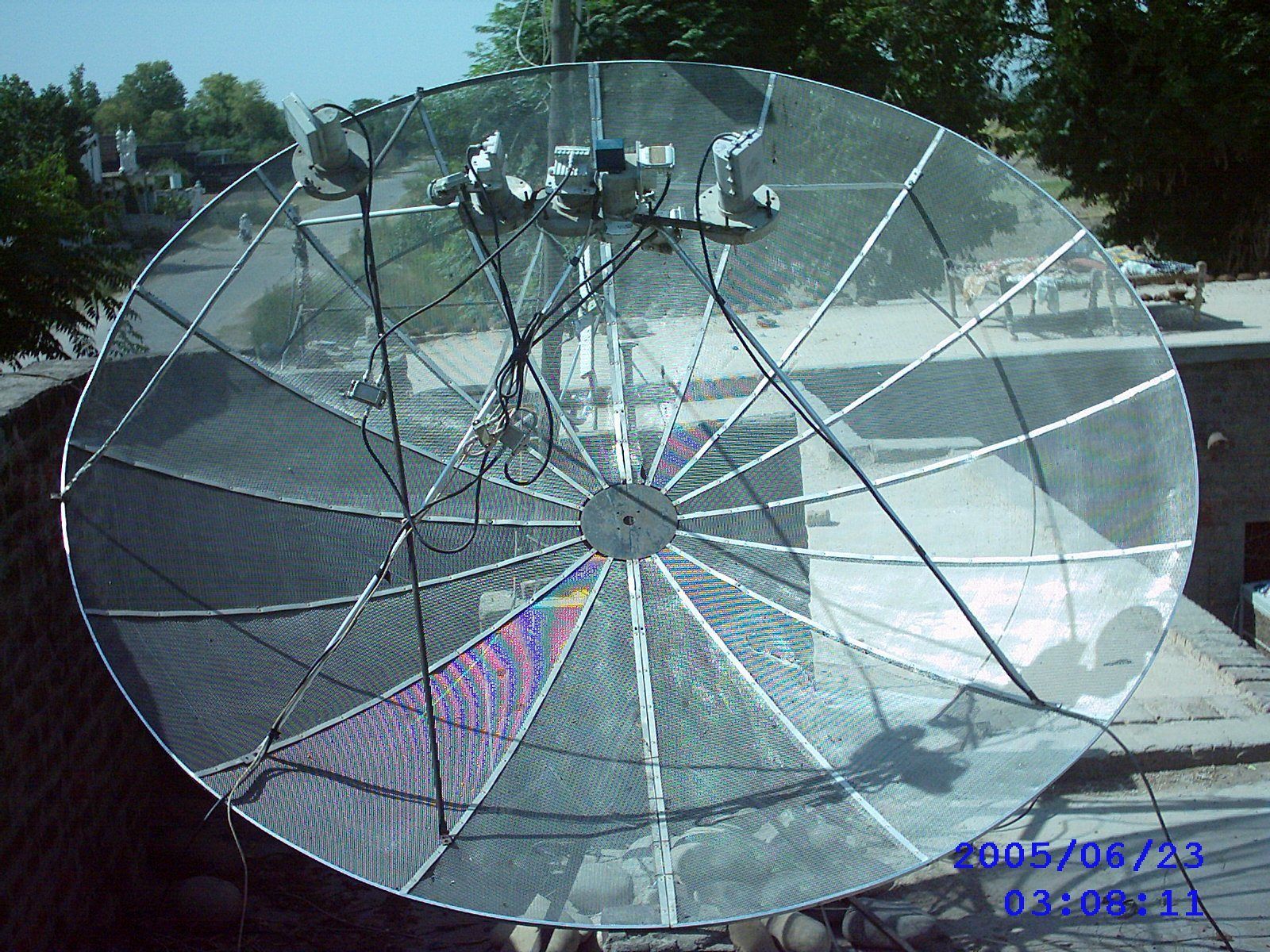

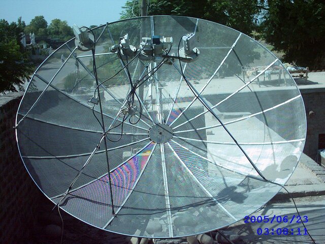

See what this guy from Pakistan has done. 7 lnbs on a dish. Very encouraging pics

That would be the "same" satellite and not the adjacent one?
Is quality of the signal the same on both?
Nice picture!
signal quality 90%
signal level 70%
both satellite signals telstar 10 c-band & intelsat 7/10 c-band.
