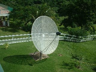

Hi everyone. Im currently installing a c/ku/dbs feedhorn to my BUD. The BUD is over 10ft tall. I removed the original feedhorn and I put this one with all the lnbs. Im recieving a very weak signal from the c-band lnb and not recieving any signal from the ku and dbs lnbs. How can I put properly the feedhorn? Since the dbs lnb is hanging in the scalar ring I dont know what is the best position or what is the problem. Are the 110 and 119 satellites near satellite G-0(or G-10)? To program the BUD Im using a General Instruments 350i analog reciever. Any help will be appreciated...Thank you!

Hi. I tried that alredy but the only signal that Im getting is the c-band only. That's why I was thinking that the problem was the position were I put the feedhorn. If I put a signal amplifier, would that help? What signal meter will be useful for these? The reciever has one input for c and one input for ku. What braket I should move? Since the feedhorn is attached by 4 poles, I dont know what is the bracket that you are talking about. Thank you for your help!...
The picture of my BUD is this one:

The DBS position should be on either the extreme east side or the extreme west side of the ARC (I would think). As Gabshire said, from G10 bump the dish towards the east a little and you should be able to find 119.0w. If you have a satellite programmed in your GI 350i that's close to 110.0w, you should be able to go from it in a similar way to find 110.0w. What kind of receiver are you using to get the DBS signals? The GI 350i won't receive them.
I think the bracket somery is talking about, is the Scaler Ring (that the DBS lnbf is made into). You should be able to adjust the distance of the Feedhorn assembly from the feedhorn itself and the scaler ring. The feedhorn should be able to slide inside of the scaler ring, toward the dish or away from the dish. Do you have a separate cable for the ku running into your GI 350i receiver? Do you have a separate cable running to a receiver that will handle DBS signals?
