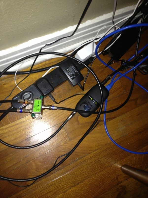

The C31s are connected via the SWM as well as the HR34. The cabling coming in from the LNB to where the HR34 is goes into a splitter where it's connected to a black DECA-2 adapter which is connected to the power adapter on the other side and the other out port on the splitter goes to the HR34.

You lost me there, perhaps a photo or something, there should be no DECA in that setup. Is it just a splitter with the PI on one side, if so that isn't necessary, the PI can go directly between the receiver and the LNB/Switch/Splitter.

This is what is on the opposite side of my living room.
Is that DECA being used as a wired cinema connection kit? That is an ok way to connect your SWM network to your router if that is what it is hooked to.
If that DECA is connected to a receiver than the setup is wrong since you don't have any old receivers.
If you go to a wireless kit you'd remove all that, but if it is working I wouldn't change it.

It is being used as a cinema connection kit. It is connected to a wireless router turned bridge which is on its last leg. I figure the cck-w would be more stable.
