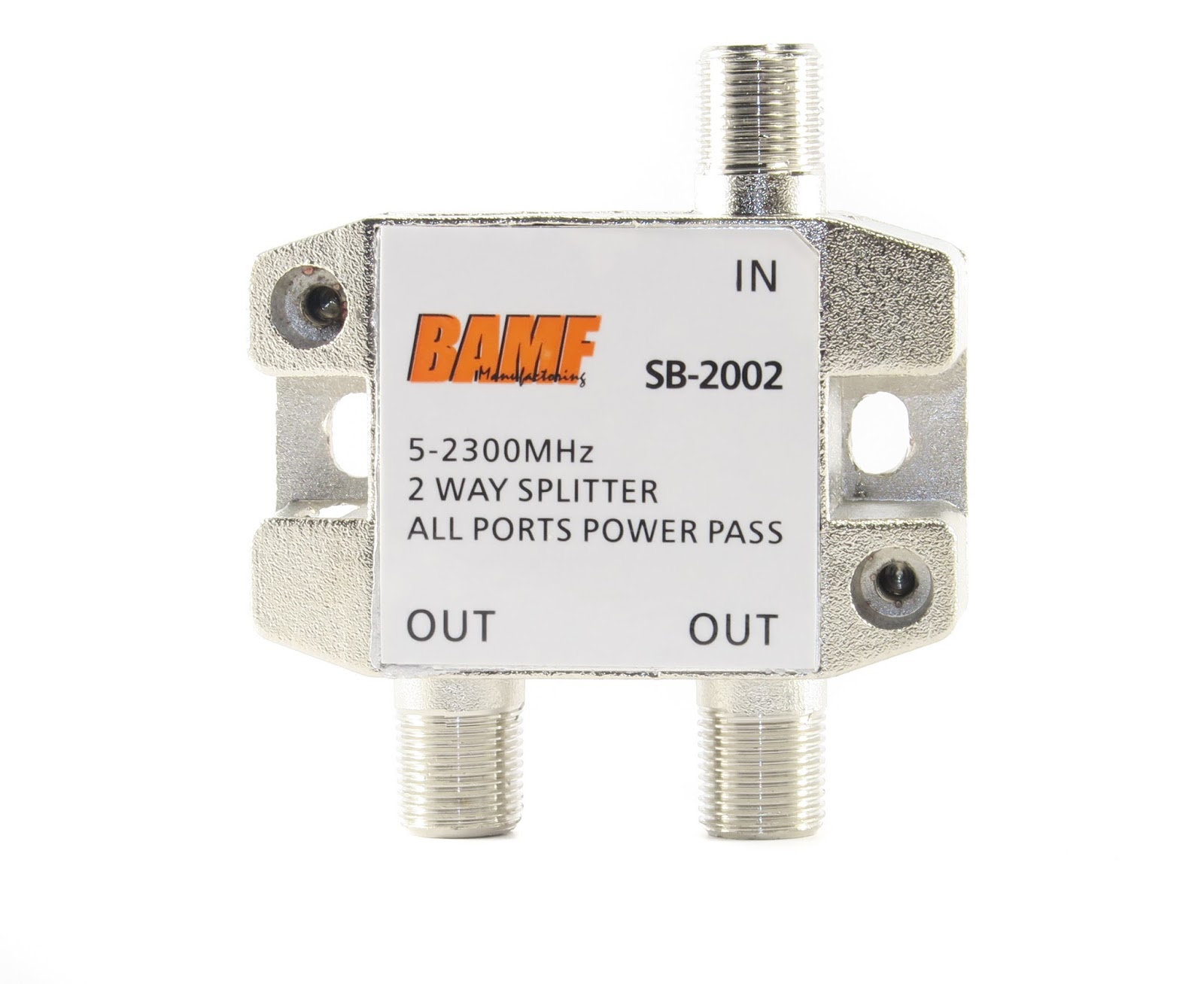

Looking to split a line into two as Norsat LNBs only have single output and with dual LNBs on market i have either no signal or on the edge of pixelation. Bought a 2x8 passive switch but there seems to be great amount of signal loss. I understand that any splitter will result in signal loss but are there any good proper splitters that minimize signal loss?
A 2.3-3GHz rated 2x1 splitter would be best. I have been very impressed with the BAMF brand units. They have 3.5dB loss each port and great isolation. Much better than the 10.6-11dB loss on a 2x8! [emoji44]

Would this be the one?
http://3.bp.blogspot.com/-IQc7qfYSJ.../e65db5d98269e5344d554168f6eaa6956734d8b7.jpg
A question with this splitter , would both TVs be able to watch H/V at the same time?
