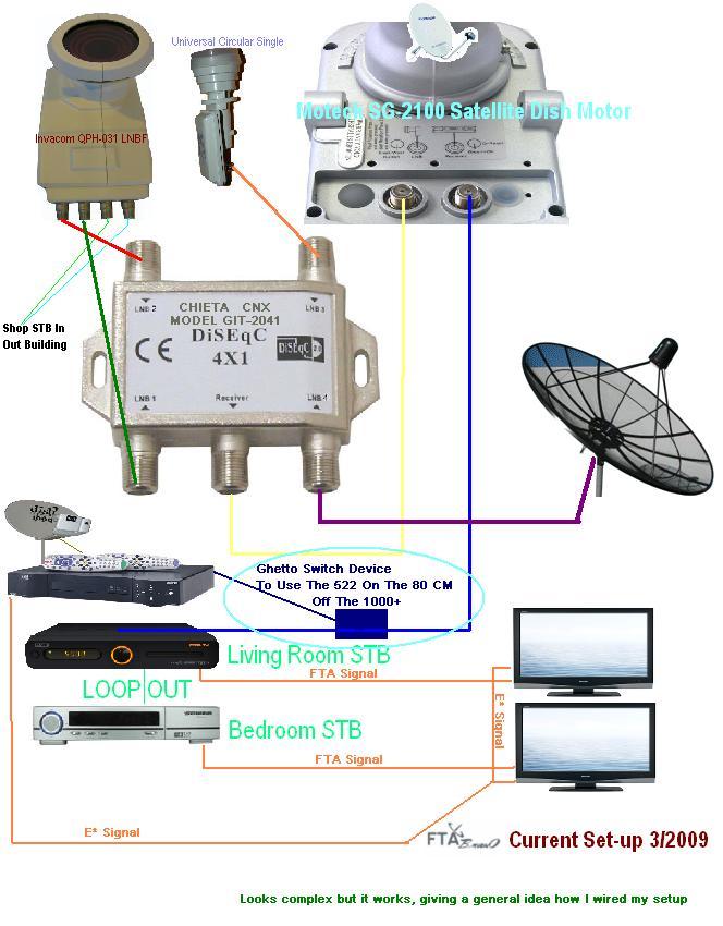

This question has most likely been asked before here on the forums, I did look around and seen different suggestions and ways but will give it a go again, I was thinking of getting an OTH HDTV antenna for the HD sets I have this year. I want to put the thing on my out building where my 80 CM dish is now and having if possible using the same RG6 coax as a lead in to my HD TV’s.
My question is can any diplexer out there work with existing FTA setups or is there something fancy you got to do to get it to work?
Right now with the existing setup I pick up nothing on my LCD HD ready sets and have gotten a couple things to come in with the old twin antennas that came with the older sets. I was wondering if it can be done with the existing diplexers out there on the market. Any suggestions welcome!
Guess what I am asking in short, can you use regular diplexers (like the DBS ones) in a FTA set up? Can the ones work that work with DSS systems work with our equipment?
Comments or suggestions on where to put the diplexer in the FTA line? I know I need 2 of them, one out at the dish and one inside to split the signals.
Drawing diagrams on how you would do it also welcome! :)
Picture is what I have now as my current set-up.
Thanks

It depends what frequency your lnb is outputting if its bellow 1450 mhz then yes it will work. Most likely your lnb outputs 950-2150 if this is the case you would only get signal on some transponders.

DBS diplexers can be used for FSS systems, but diplexers introduce signal loss that you may find unacceptable. We require that Glorystar (FSS) installations be direct connections without diplexers and suggest that our customers do not use them if alternatives exist.
On a personal note: With a direct connection to an outside terrestrial antenna I am able to reliably receive San Francisco and San Jose channels. Add a diplexer and the channels Signal Quality drops to threshold with severe blocking while some channels disappear completely. FSS signals loose 5 - 10% quality. Needless to say, I use separate cables!
Wow, so it is not like using the old diplexers like on the DBS stuff when you added an OTA antenna! Thanks Brian! That answered my question 100%! NO I do not want to have any insertion loss on my FTA system!

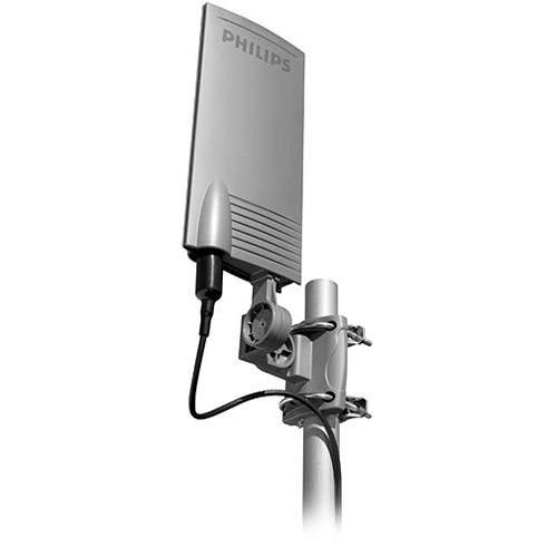

I have one of those Phillips MANT940 Indoor/Outdoor HDTV antennas that is amplified with a wall wart. I will use that in the bedroom. It seems to do well inside but would do much better outside. I just want one bigger for the main system in the living room, further coverage so to speak. :D

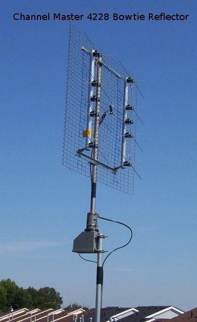

The Channel Master 4228HD is considered one of the best OTA antennas out there. I am considering adding one to my antenna farm :)
Hey thanks Tron for that suggestion! Price is right where I wanted to pay and it does not look like we are back in the 70’s with those long VHF -UHF reception element antennas. I will be looking to purchase one here real soon!
