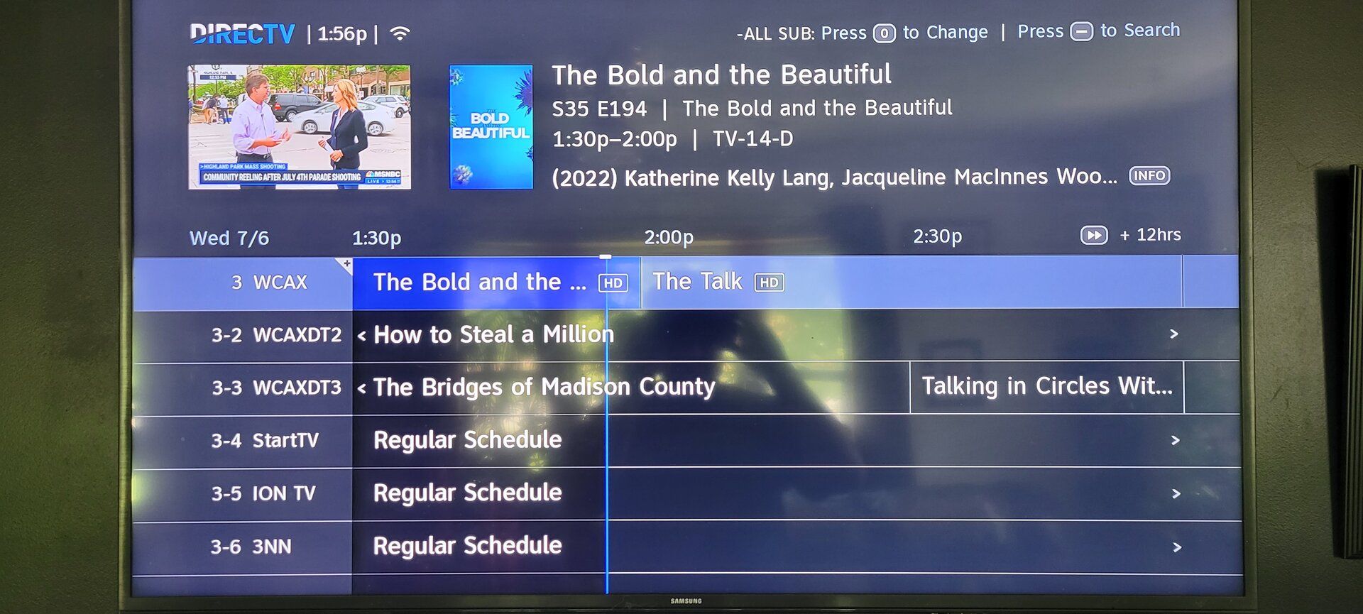

This is what the guide looks like with a HR44 and AM21 and partial database matches. There is also a 3-7 This TV.
To expand ... Any thing with a .1 ext. will be an OTA channel
The one without the .1 is the D* provided channel ...

Kinda...
When you look at a local, the Directv provided local will just show 3 WCAX. The OTA channel will show as 3-1 WCAXDT (i don't have the duplicates in my favorites list). Subchannels that match the database will always be in the 3-2 WCAXDT2 format, but those not in the database show as whatever the channel has the PSIP call sign set up to be, as shown above.
When I lived in NC, there was Directv-provided 26 WUNL and Directv-provided 26-2 UNC-EX. The 26-2 that Directv provided was 26-3 OTA. I have seen some markets just poking around where a CBS affiliate will be on xx-1 and like NBC will be on xx-2 and they use the dashes. Sometimes, they will just use the next channel up. So, if my hypothical CBS was channel 3, they would put the NBC on channel 4 in that case. I assume newer additions use the dashes and older ones don't. Also, the RSN alternates use dashes and those are not OTA :)
Some Directv-provided locals are HD/SD and there's no way to immediately discern without looking for the HD flag or at the info of the channel. This will be an issue as Directv starts to switch SD locals to MPEG4 - our receivers won't be able to tell the difference between them and both will display, even with SD duplicates hidden. It is this way now with a few random channels in a few random markets. Everyone can see an example as some of the Spanish HD channels have MPEG4 SD counterparts - if you manually type 465, it goes to the MPEG4 SD version, not the HD. You have to use the guide or channel up. EXTREMELY annoying. Hopefully they figure something out for that.
Edit: One more thing - some markets are having their SV locals replaced with phantom channels. If your market has CBS on ch 3 but you have a SV CBS on, say, channel 22, the SV CBS on 22 will still show in your guide with its call letters but the guide data and programming will be your actual local CBS, NOT the SV channel for which the call letters are shown.
