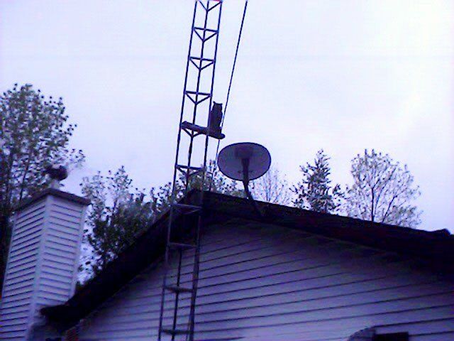

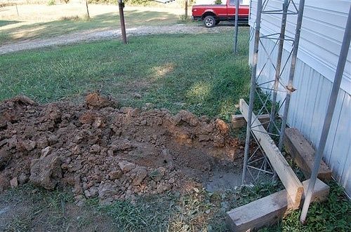

There have been a number of post about dish hunting but there is something else to keep an eye out for and that is the old 3 legged TV antenna towers. Each section is 10' and they are great for small dishes (or digital OTA antennas). I found two 10' sections laying in a field and the guy just let me have them. It's a lot like the dish story. Years ago, long before satellite TV, people put up these towers in order to receive better TV signals. Now they have a small dish or cable and no longer need the tower.
The attached pics are not of my tower. :)

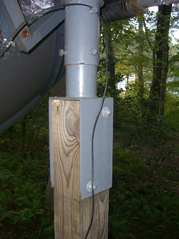

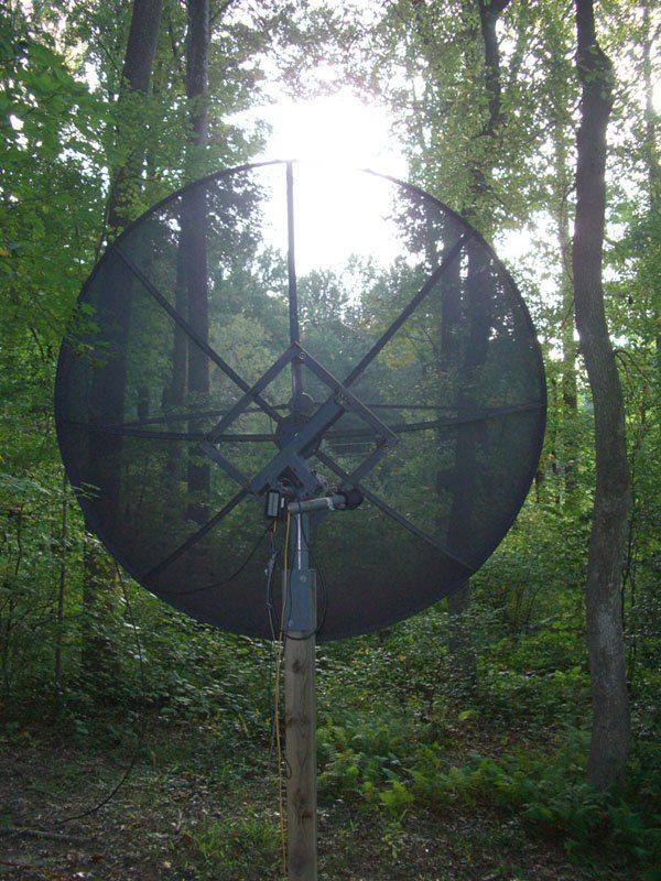

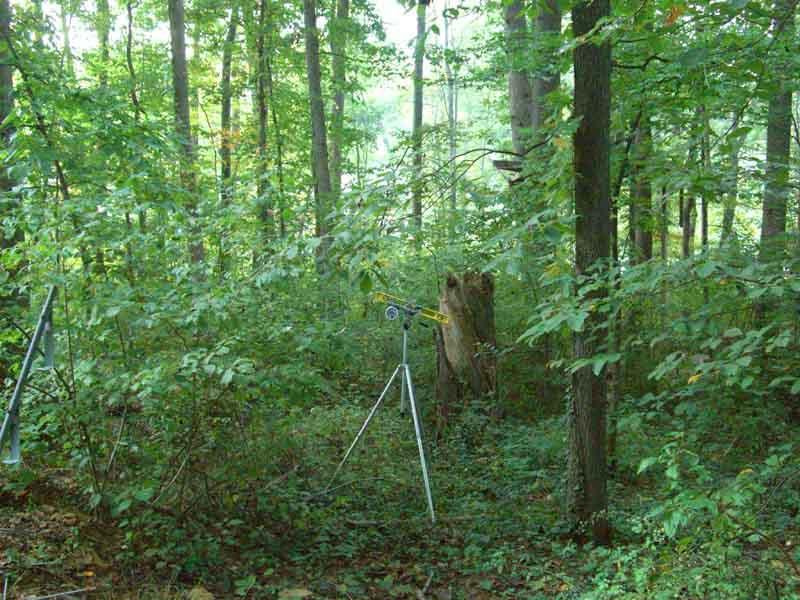

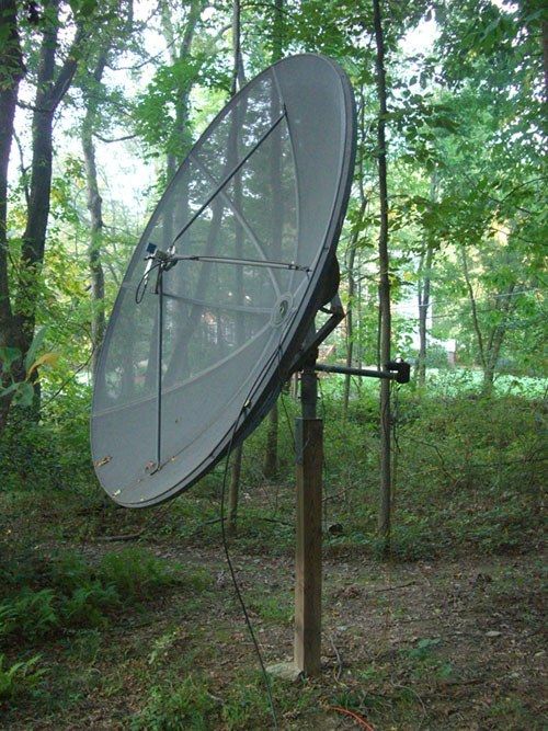

I took some pictures of my dish and where I want to put it. The view from the tripod is of G3. I should be able to get from W3-W5 easily, and hopefully the west satellites if I can get the dish high enough.. It doesn't have to go over the trees, just over my neighbors trees then I can cut the branches off mine

When you go to the local steel supplier just lift one end of the 21' x 3" pipe and watch how much it bends. A 21' x 3" pole is going to flex too much unless you add guy wires to stabilize it.
If your really serious about a 21 foot pole free standing setup, then look at using the next size pipe about 14 feet and double wall your setup, so you will have a 3 inch and then another pipe over it, this should help stop any movement, only problem it's going to be really heavy. Like I said before call a well driller for used pipe and save some money.
one problem with your desired location is that trees fall down and crush dish components, is there somewhere away from the woods you can place it?
After looking at your first picture I think you need to invest in a really good chainsaw which will help with your site location....remember trees have a bad habit of growing.

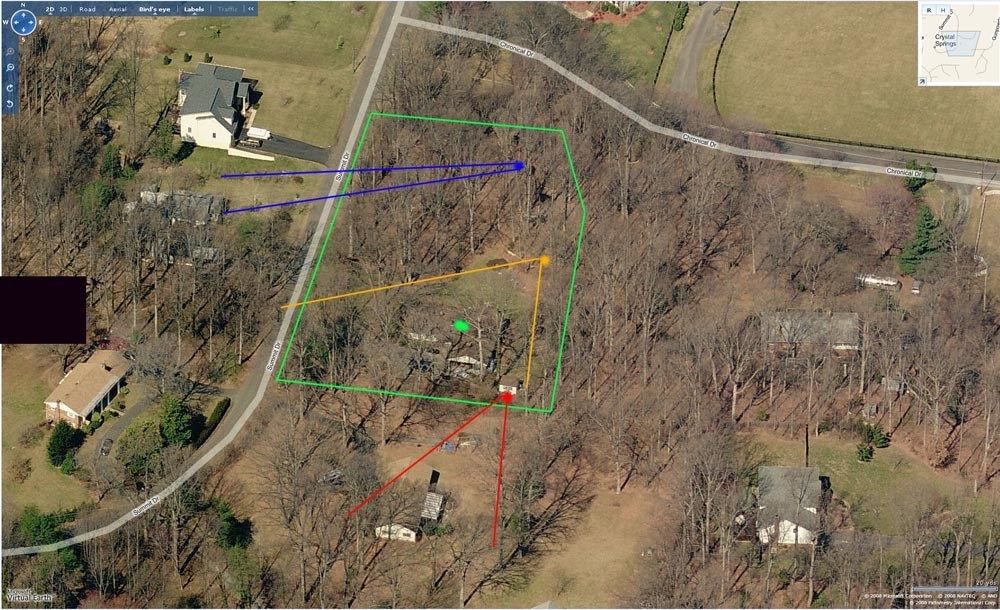

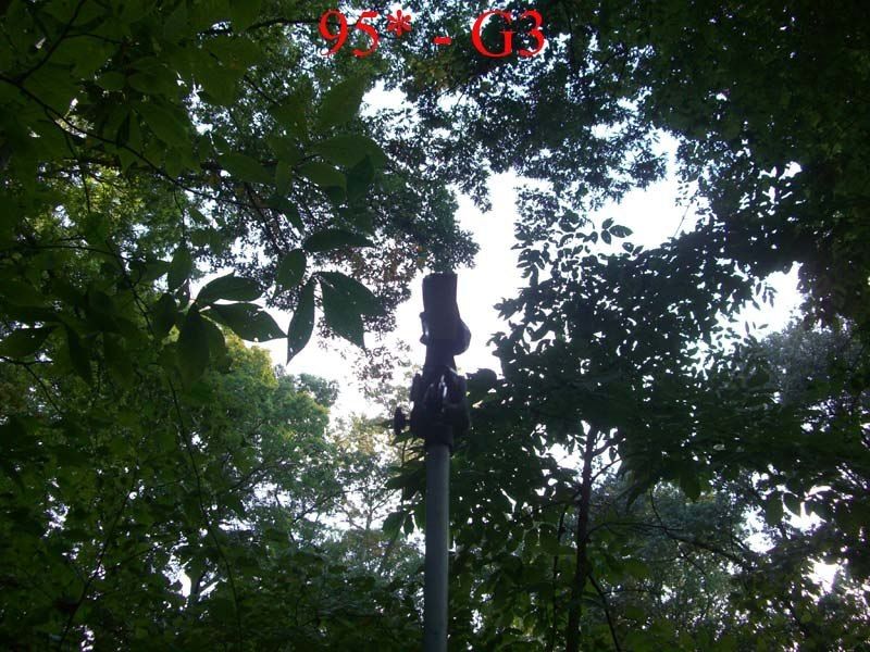

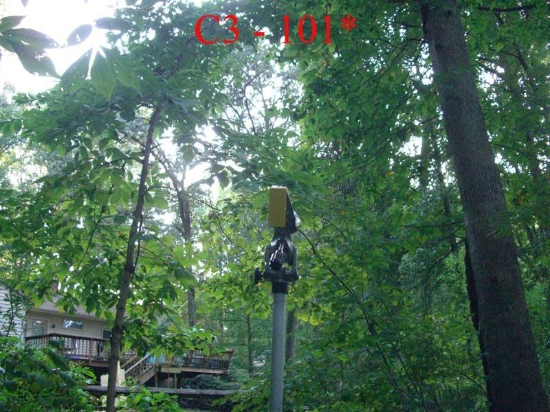

Ok here's a little site survey. The orange is where I wanted to put it. The blue is where my dish is now. The only reason I put it there was so I could get Comedy Central.. but it's no longer on C3 anyways. At the orange location I'm sure I can get 87*-105* with a full view, but I'm not sure about the other sats. I posted a view of C3 and G3. Most of the stuff blocking it I can easily get with a rope saw btw.. except C3 b/c it looks like it might be aimed right at the trunk.
The red location gets most of the eastern sats but would be impossible to get the western ones.
