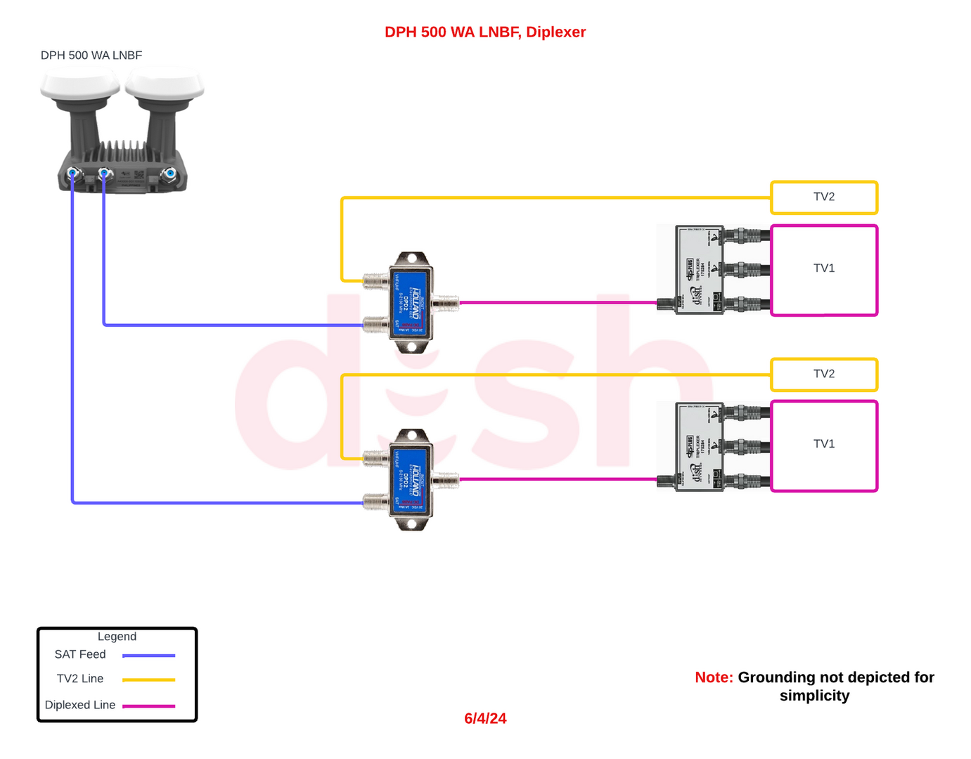

There is a new Dish setup coming out this month.
DIsh 500 with the same backing structure as the 1000.2 and new DPH WA 500 Twin that will run Hoppers AND VIP's, including 211K's and 722"s
  • The DISH Pro Hybrid (DPH) 500 WA LNBF is designed to point at the western arc satellites
    • DPH LNBFs and switches support band stacking (2 tuners) or FSK channel stacking (16 tuners)
  • Outputs
    • 2
  • Inputs
    • 1
  • Switches
    • LNBF has an Internal switch
      • Turns off when connected to a compatible external switch
      • Note: The DPH 500 WA LNBF is the only Hybrid LNBF compatible with a switch
  • Max Receiver's
    • 2 ViP Single tuners
    • 2 ViP Dual tuners
    • 2 Hopper 2000's or Hopper With Slings
    • 1 Hopper 3
      • Port 2 turns off when connected to a Hopper 3
    • 8 Wallys in dual tuner mode with DPZ Channel Stack Splitters
      • Port 2 turns off when connected to a Wally
      • DPH Power inserter required
    • 16 Wallys in single tuner mode with DPZ Channel Stack Splitters
But apparently, NOT Hopper Duo's??

I would wait since the new one is so versatile with all the different systems
Will this LNB work on the 1000.2 since ther are so many of them?I'm a little confused what the backing structure is
The backing structure is going to be the same as the 1000.2 but the reflector is going to be the 500 and I don't know if they work together. As soon as we get some, I'm going to test it.
I don't think that will work. The arm on the 1000.2 backing assembly is a few inches longer than the arm on the Dish 500 backing assembly. That would throw the Dish 500 reflector signal different than the 1000.2 signal. Probably the LNB bracket that connects to the arm will be shaped differently also.
Yea the lnb will have different soabobg to accommodate the way the reflector distributes signal
So have you heard what they are doing for EA? Are the existing lnbs supposed to work with this dish? They said they plan on doing away with the 1000.2 reflector so I'd assume that means both arc will work with the 500.
