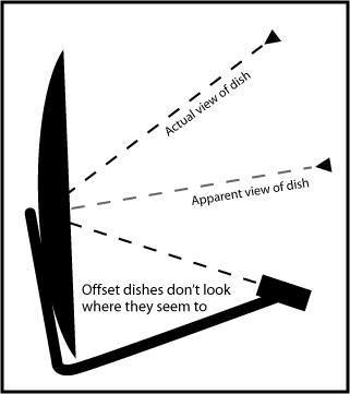

"The satellites are not in a direct line with the LNB arm."
This is the first time I have ever heard that and I was absolutely under the impression that they were. What an idiot I am! I would find myself sticking my head in the dish trying to look up the line of the LNB arm and thinking "it looks like that tree is right in the way". The bank shot analogy brought it home.
Thank you 100 times. Some of us take longer to learn than others.
Here is a crude visual as well:
