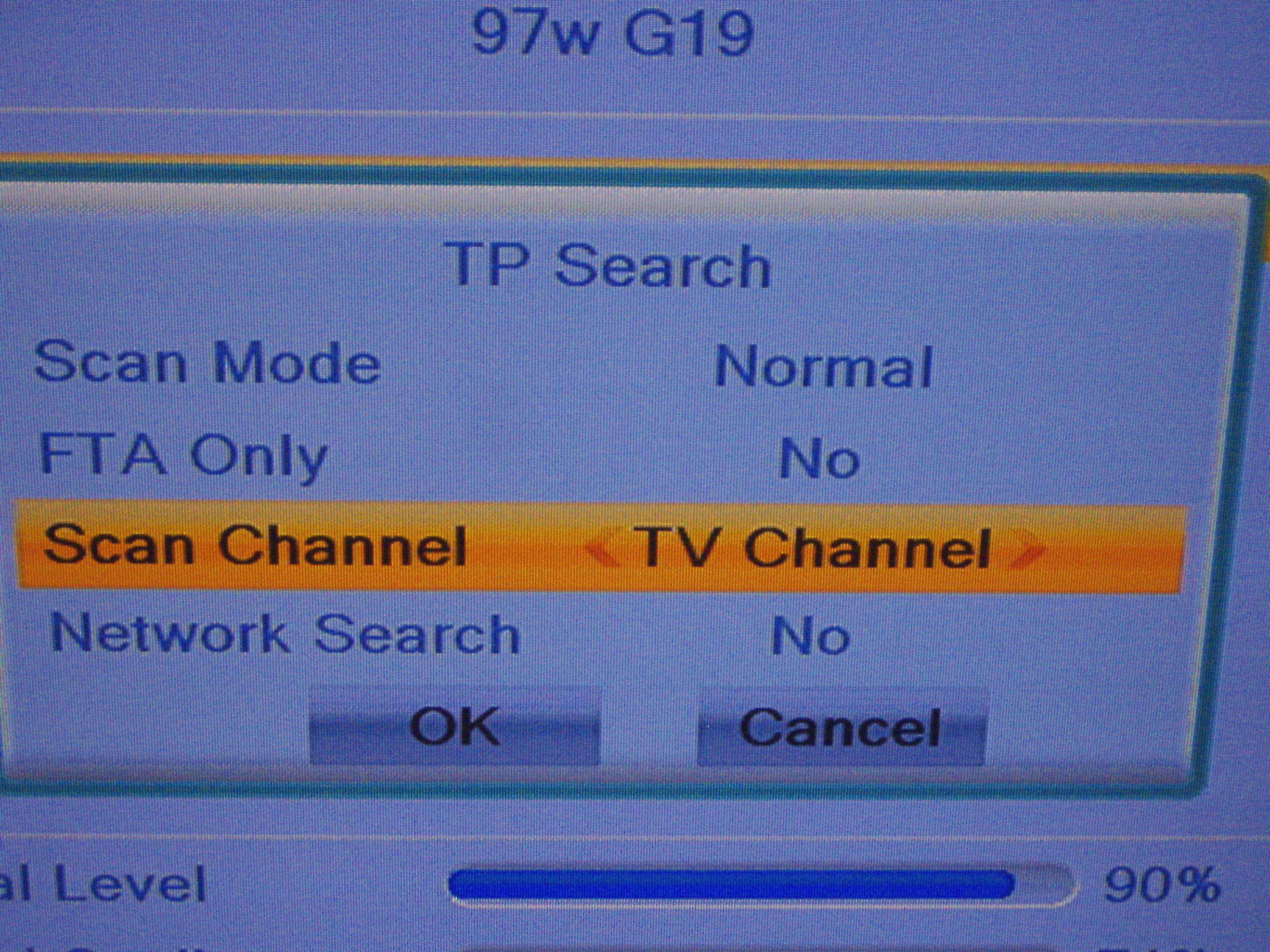

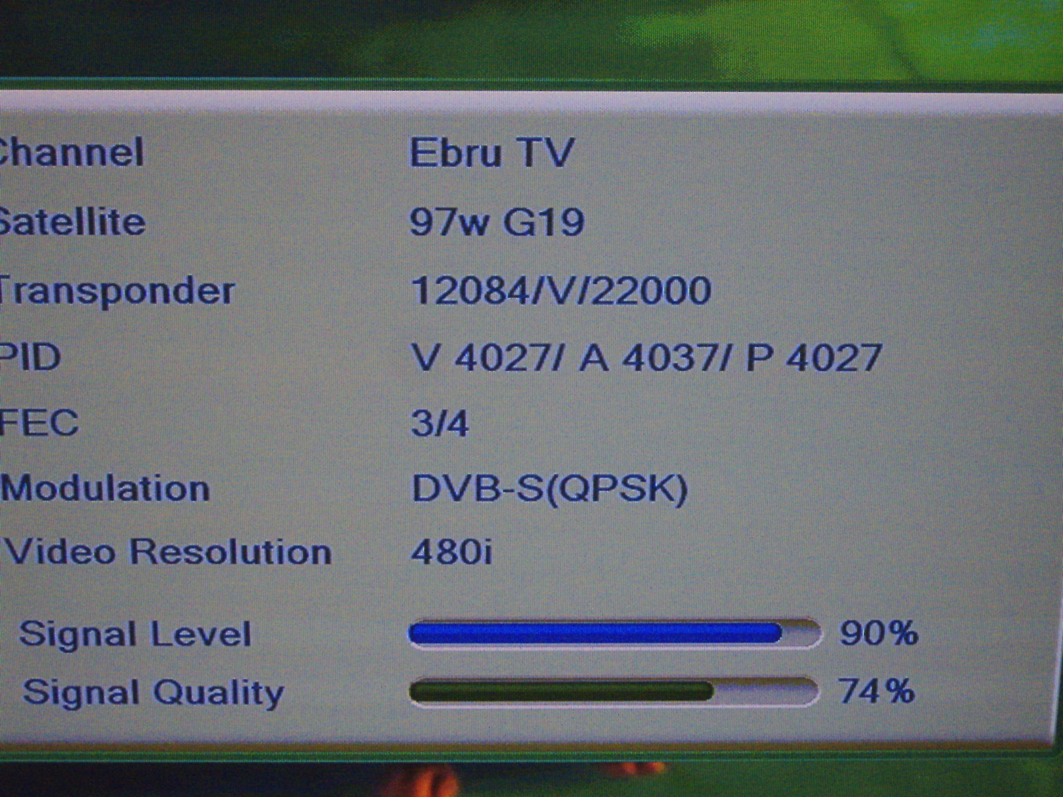

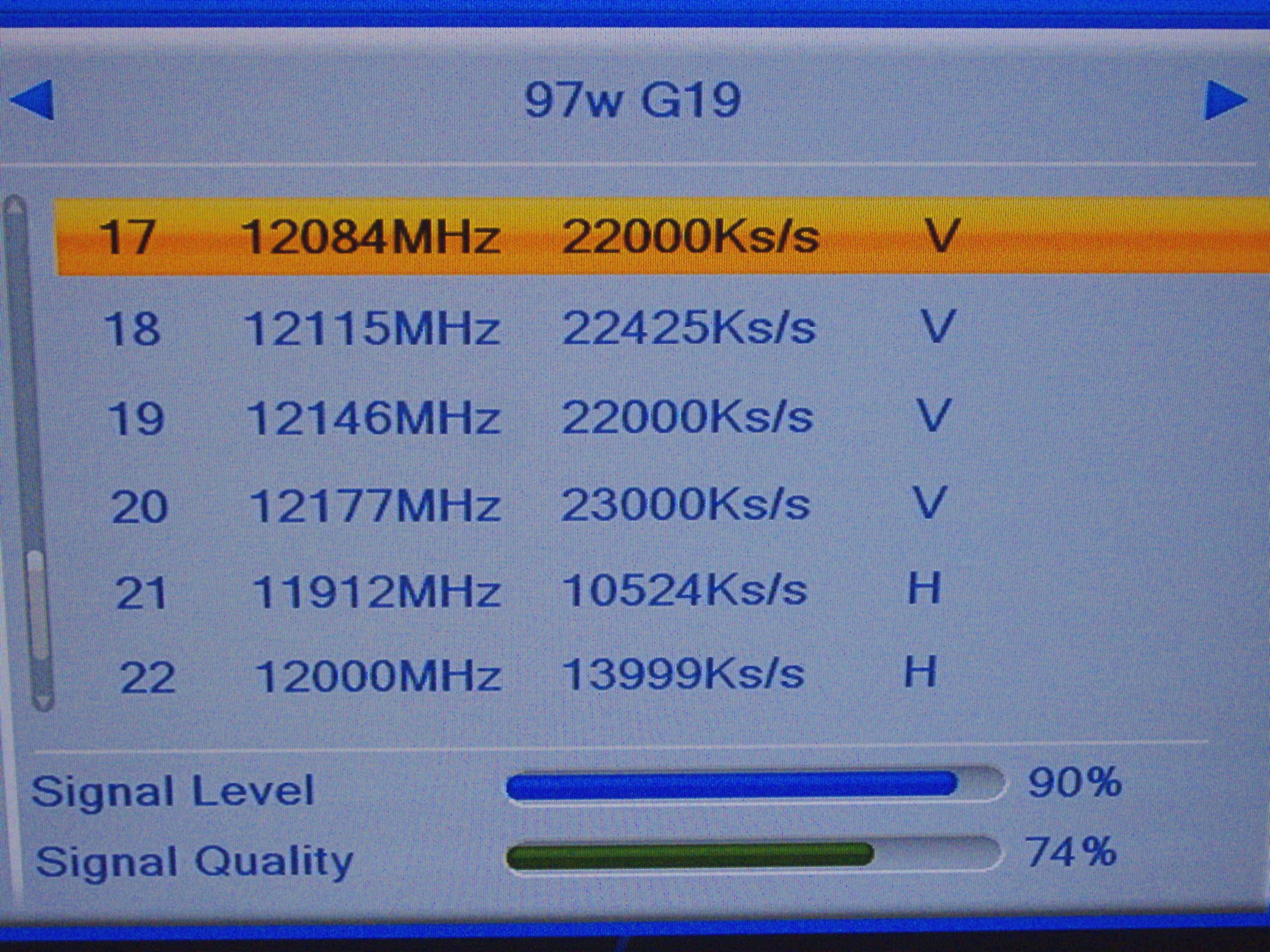

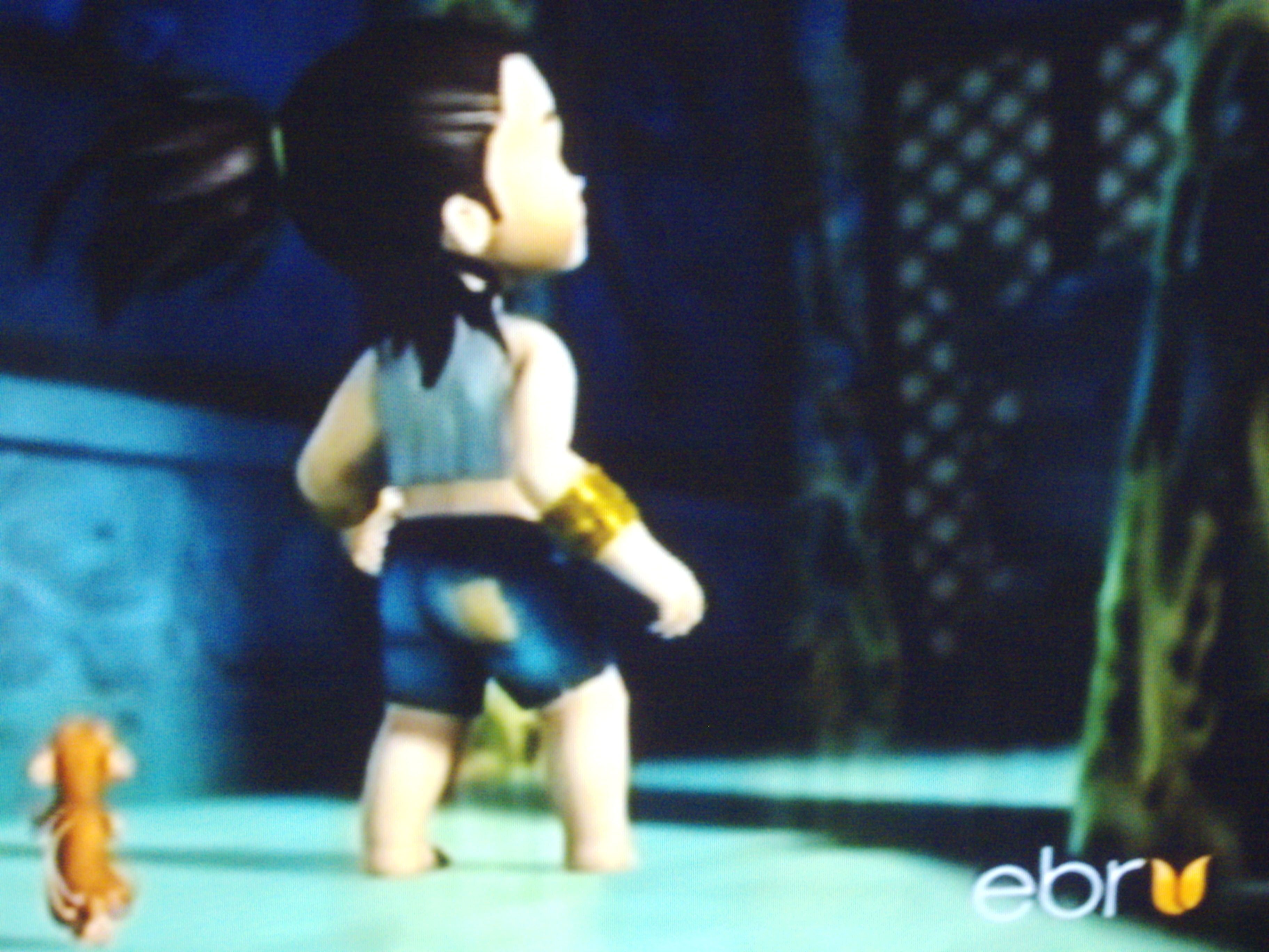

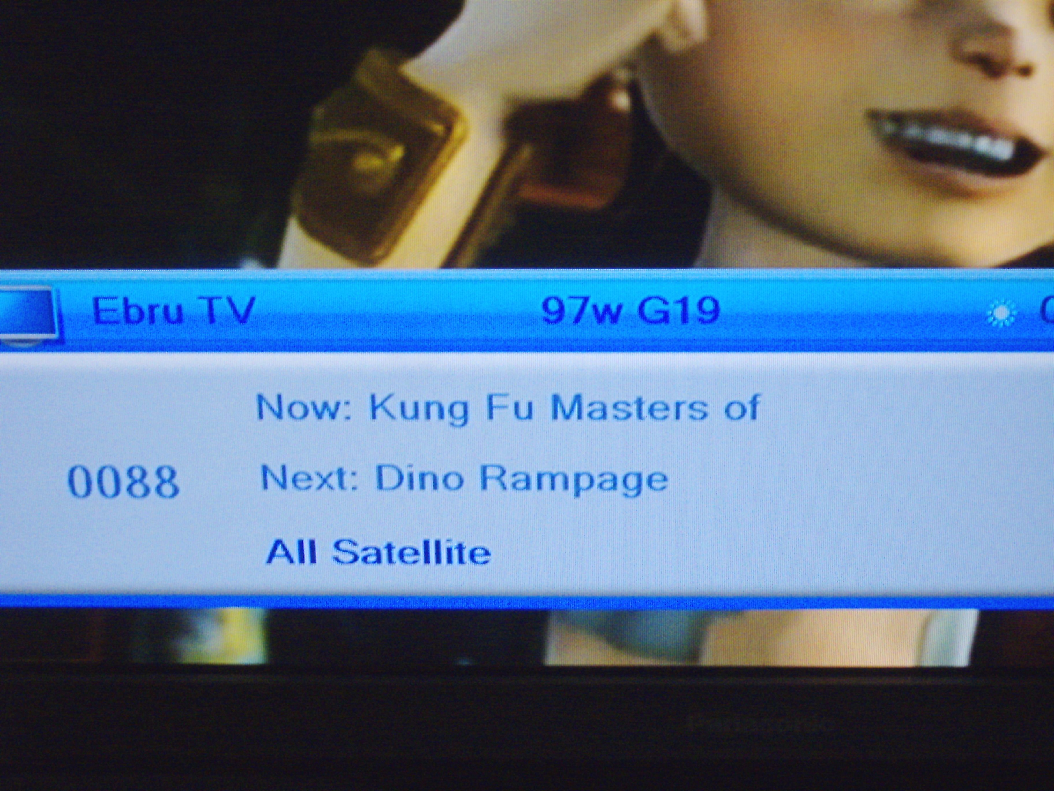

I had no issues scanning the channel in about 5 minutes ago...screen pics
I made sure I was on 12084 V 22000
hit OK
I changed to TV (so I didnt have to remove any radio stations)
logged in no problems
