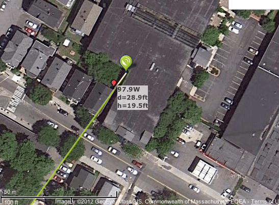

1. So if I don't place the dish on the pole, here is the LOS from the balcony. Should I raise the dish higher?
And here is the pic from dishpointer. I am on the top floor, but landlord really does not want me placing anything on the roof (even the non-penetrating stuff)
Depends..... The satellites are in an arc. The satellite orbital position that is similar to your install location longitude will the highest point in the arc and slopes to the Eastern and Western horizons. The dish line of sight may clear the buildings directly south of you, but will same dish location provide line of sight for the rest of the satellites that are lower in the sky to the East and West?

I am really trying to just hit Galaxy 19. Whole setup is just for one channel - LTV World.
Latitude: 42.3953°
Longitude: -71.1187°
Satellite: 97W GALAXY 19 (G-19)
Elevation: 34.5°
Azimuth (true): 215.7°
Azimuth (magn.): 230.7°
If a fixed dish, either measure out the heights as provided by DishPointer or if you have a digital level (or smart phone digital level app) site up towards the roof from the back corner of the yard.
Judging from the photo and tbe DishPointer screen capture.... it could be close, Probably could only be sure by sighting the aiming azimuth and elevation from the install location.
