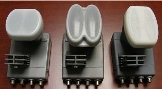

What style of LNB do you have? If it's an xku LNB then you tune a new receiver using the signal meter on channel 252 and not 299 (In the attached photo the xku LNB (middle and right) has "eyes" that are more elongated than the older quad LNB. If your LNB resembles the one on the left, then it is NOT xku and you tune to 299 and use the signal meter on that channel.) Note it will also be important to know this information when you get to the point when you authorize your receiver.
