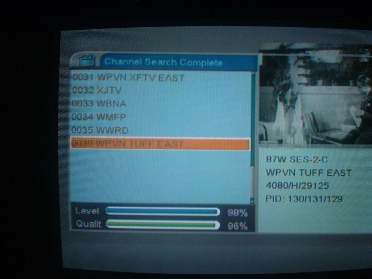

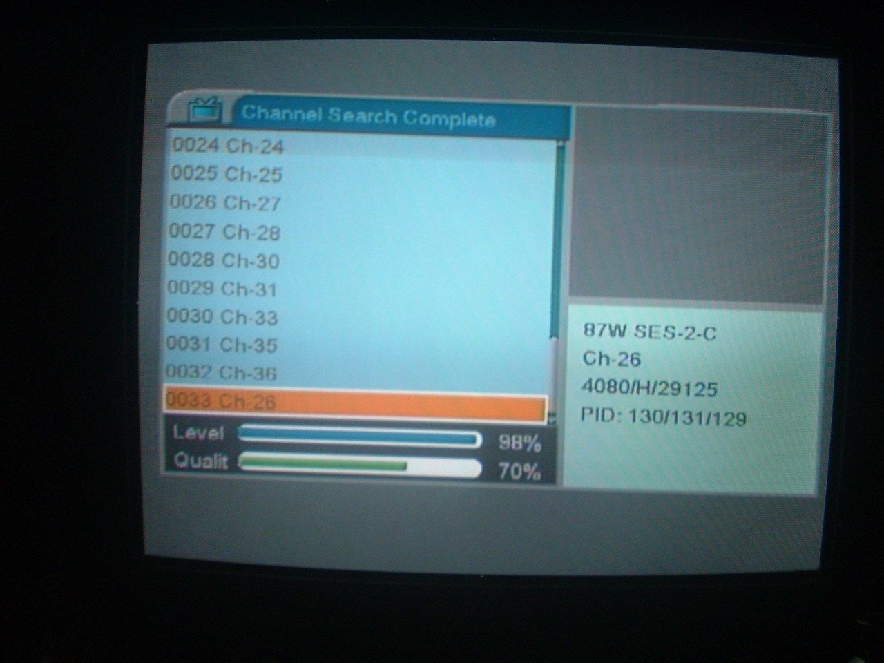

Attached are a couple of pictures that show what you get with the 9500HDX when you scan with a weak signal and what you get when you scan with a good strong signal.
The channels are numbered with a weak signal, but the channels have the call signs when the signal is stronger. Notice that there is not a picture when the quality is around 70 on this transponder. GregH
