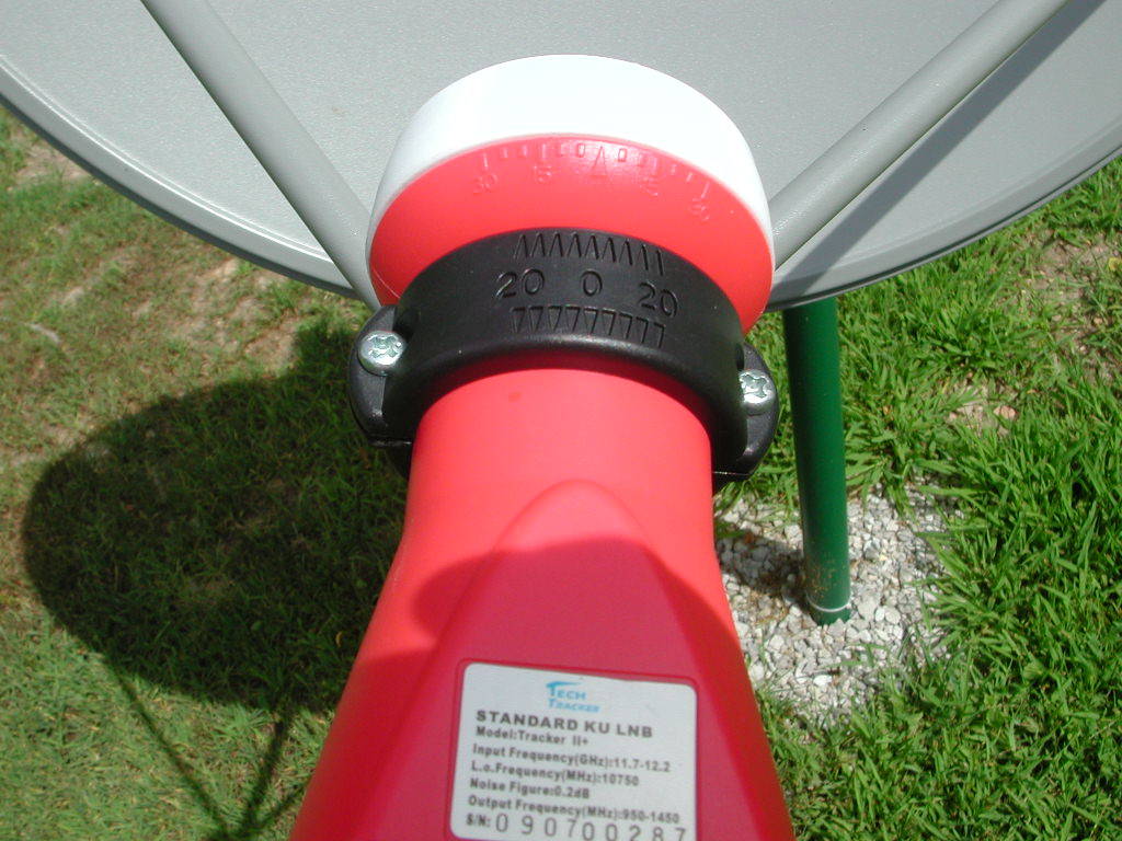

When you setup your Dish with Motor, and Pointed at Your True South Sat, the LNB should look like the Pic attached.....

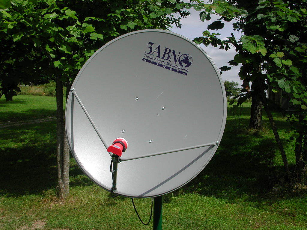

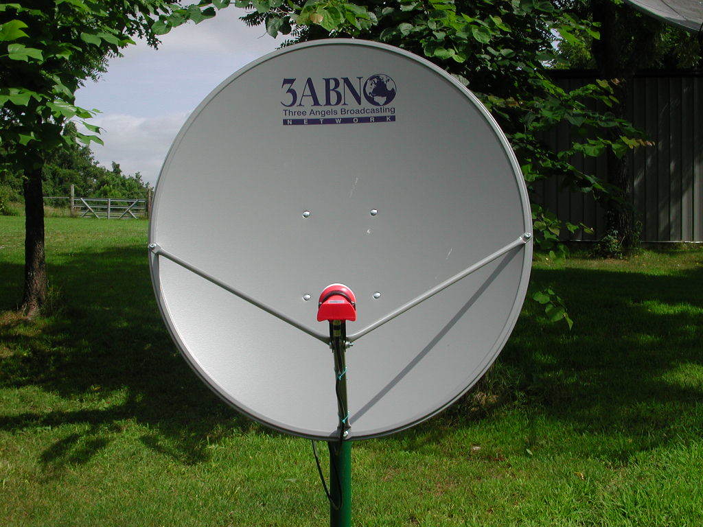

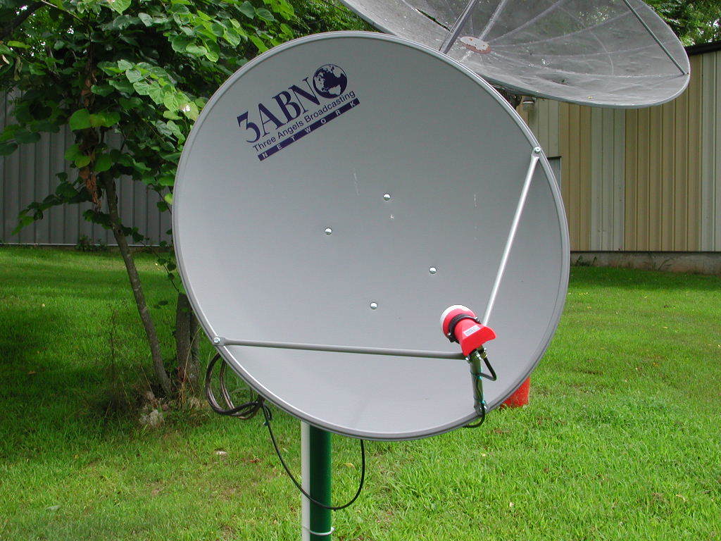

Here are some pics I took this morning that may help you to visualize how the motor skews the dish (and LNBF) as it follows the arc. The pics are of my dish pointing at 72W, 95W (my true south sat is at 93W but I don't have that location saved) and 127W. The close up of the LNBF shows that it set at zero degrees, hope this helps you to understand. :)
