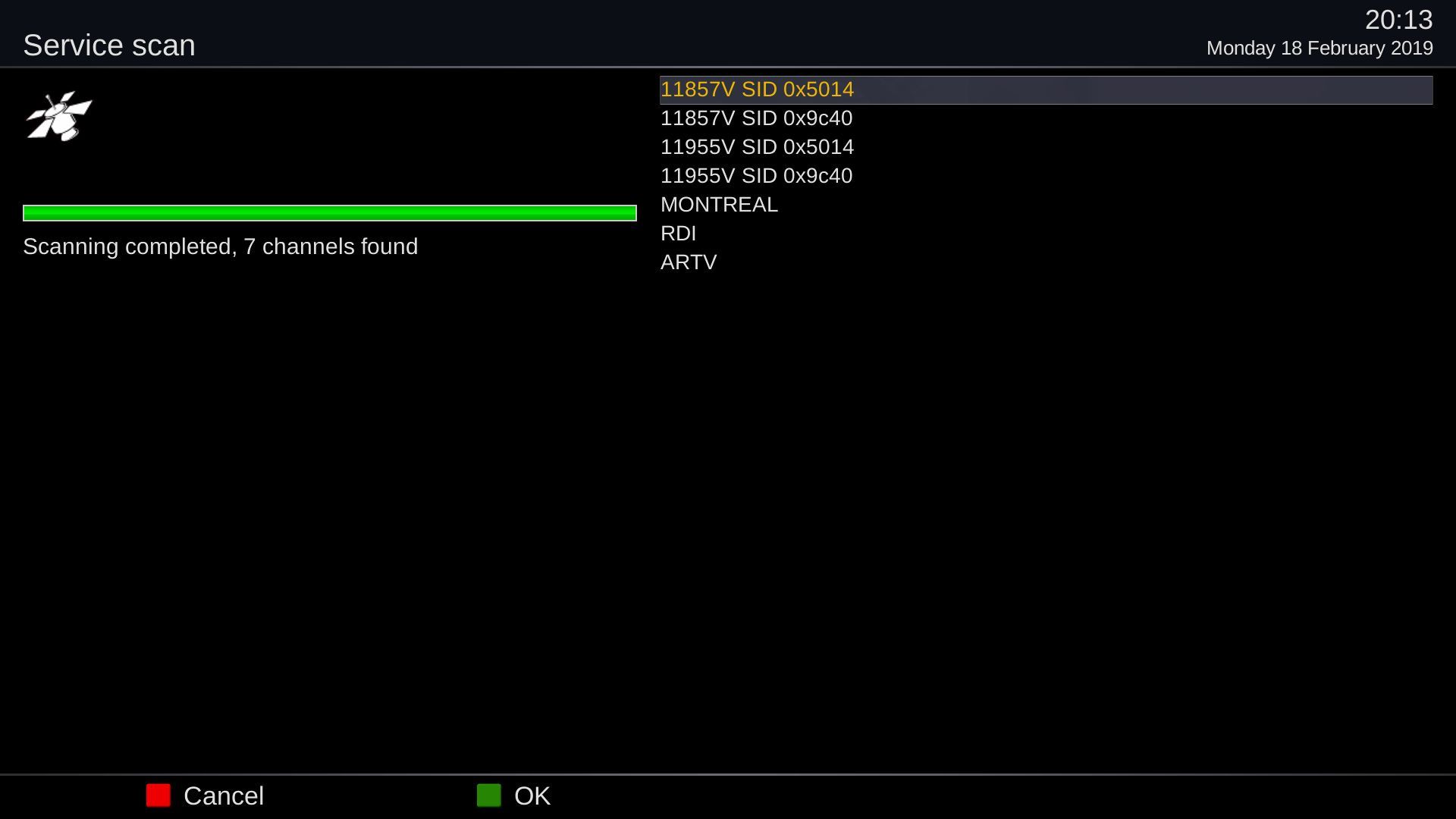

This is what I get at 114.9W
I don't know what that means. I just set the antenna setting until I found the feeds. 114.5w works best. There is curling on now backhaul at 12011V15000
