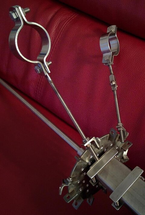

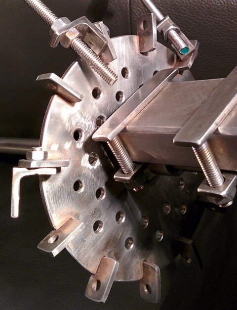

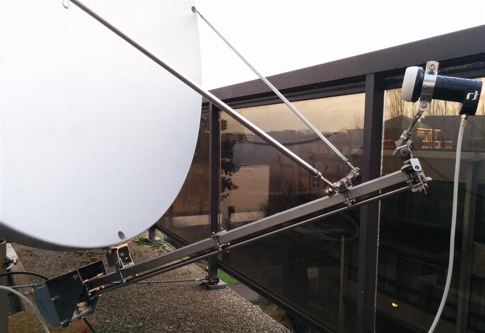

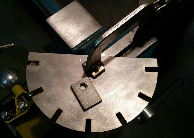

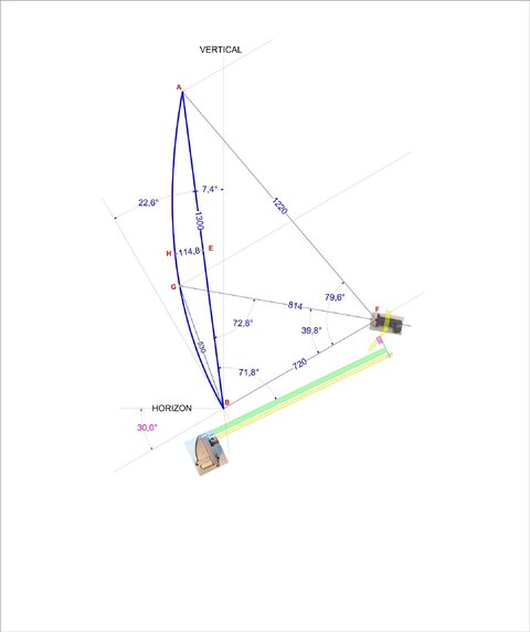

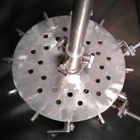

Well.... it is still in process. Simple- made a drawing ParabolaCM120cm_MotorBack (Custom).jpg , cut some metal, welded everything together, angle-grinded. And repeated process several times till satisfied with the result. Trial and error method, you know. :shh
IMG_20151201_194807 (Custom).jpg IMG_20151204_224230 (Custom).jpg IMG_20151222_174706 (Custom).jpg IMG_20151223_091433 (Custom).jpg IMG_20151223_154537 (Custom).jpg

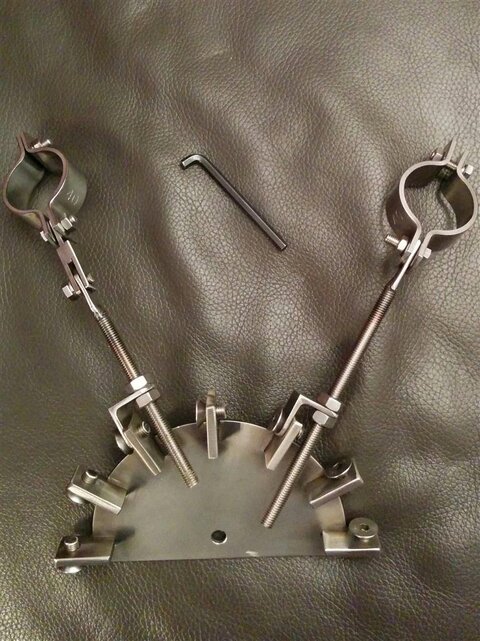

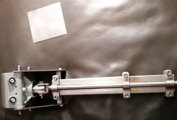

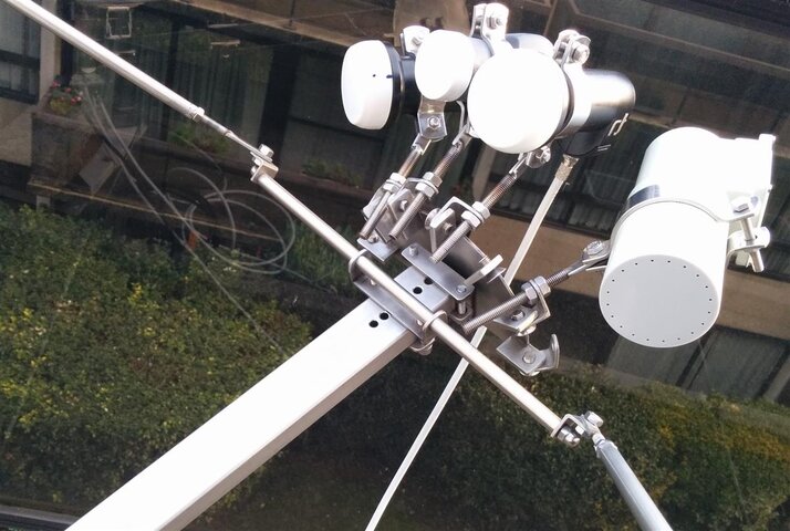

Making another LNB changer. It is still on the table, but already works. Smaller motor this time and it turns fast. 360* in approximately 14 seconds. And a small movie
IMG_20160209_170528 (Custom).jpg IMG_20160209_182118 (Custom).jpg IMG_20160209_181404 (Custom).jpg
