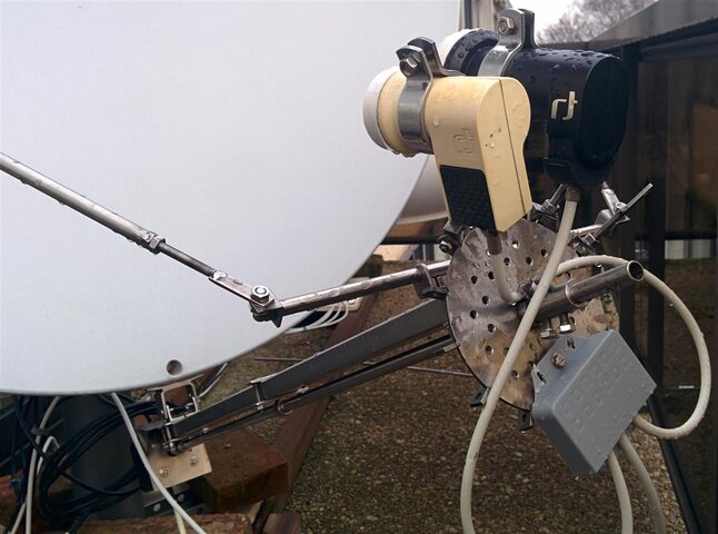

More or less I am finishing with this small project (at least do not plan to do major changes to the mechanism). Made additional slot in motor's cogwheel IMG_20160216_163814 (Custom).jpg , so now each pulse is equal about 0,9* turning of the axis. Turning axis is now located inside the bottom feedarm. On the VIDEO dish travels from 19,2*E to 12,5*W with stops on 9*E, 4*W and 11*W. LNBs are changing as needed. Do not have proper feedhorn for C-band LNB, but even without it possible to lock some C-band circular signals.

I have decided to restart my LNB-changer project, in the garage this time :coco. Motor, which turns LNBs has optical sensor inside, therefore I need positioner with
+5V. I took the simplest positioner from Sadoun sales, changed transformer to work on 220V. Transformer was little bit bigger than original one, so made a hole in the lid and covered it with metal plate. Then soldered red wire for +5V and blue wire for ground. Now this positioner is optical sensor capable.
