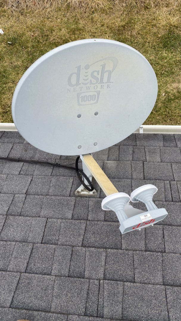

This is a photo of the dish and LNB that were up there when I had a Wally connected. Will climb up there later today and see if anything's changed since then.

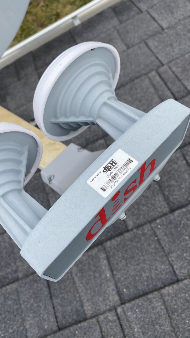

If it's the same, you should be OK< but the first pic, maybe it's deceiving as it is, but it looks like a Slimline DPH LNBF
I have to agree. It is hard to tell, due to the angle of the pictures. However, I would be shocked if the new LNBF is not a Slimline DPH.
Reactions: TheKrell and HipKat

Yep, it's hybrid. The neighbor's Duo is killing the signal output on port 2
