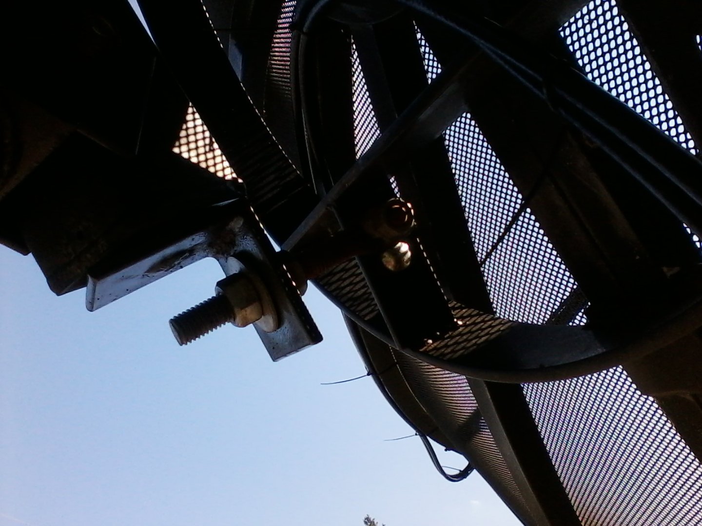

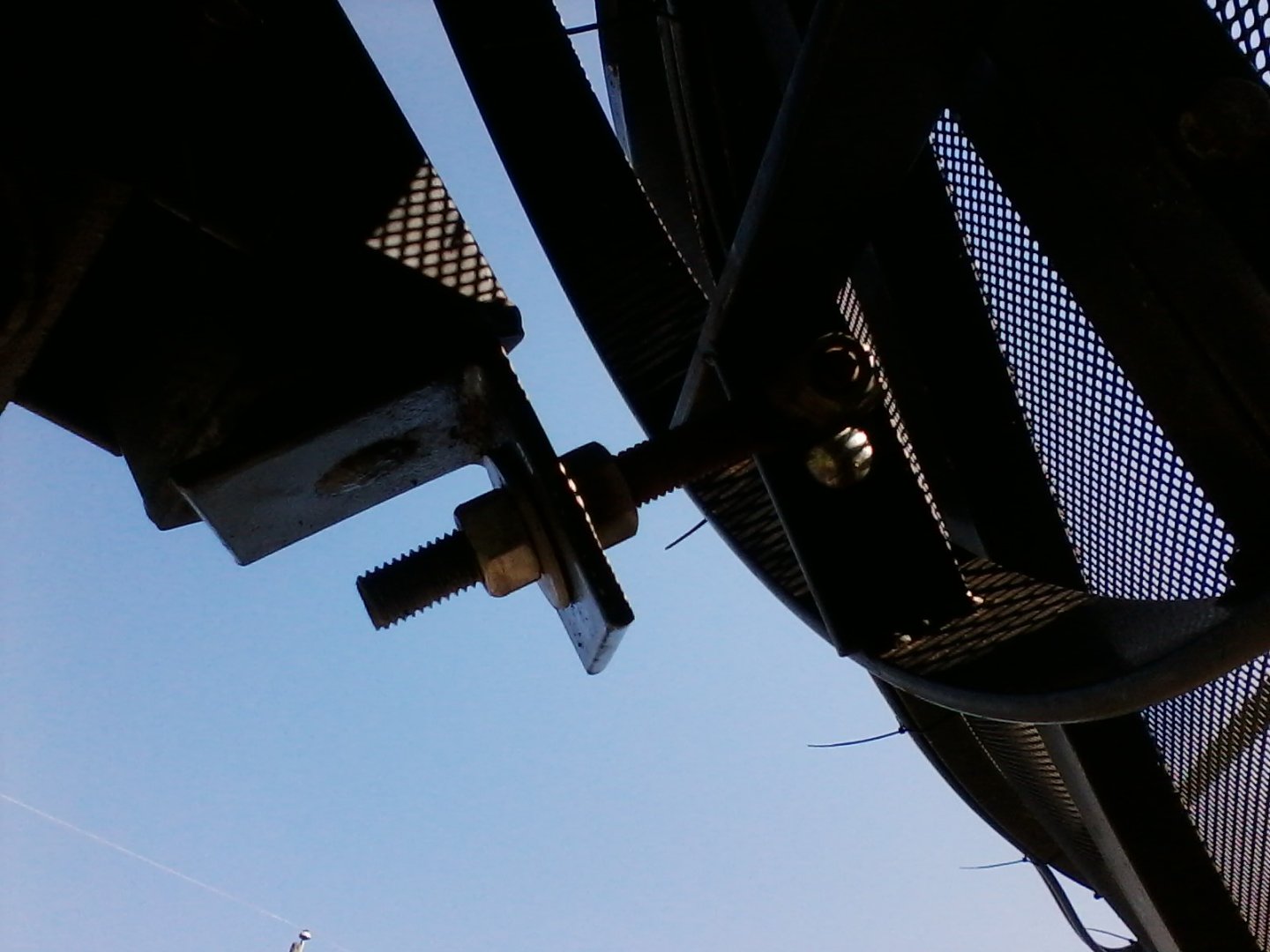

Though I would personally like to have the declination bolt not at an angle at the L-bracket, as it is now
My 7.5ft SAMI dish had the same problem, came that way from the factory. I drilled out the hole larger, so as to make the bolt go in straight. Then I used some large flat washers to cover the hole and tightened it all down. IF the OP doesn't fix his and tighten it down FLAT, that dish will flop a bit back and forth, and cause issues, mine did. k4otl

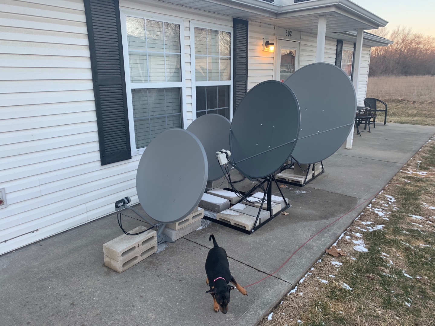

I will get to it at some point, I'll have to work on it regardless to make it track the arc better. Between 93 and 105W it works just fine. There's no slop in that bolt, it's tight as a drum, just at an angle. I'm pretty content for now (that'll likely change, look at me, I've got a 10' dish in my backyard), and nursing a cold too, so no rush on this end. And I've got a 1.2m Ku dish I need to put up at some point... I think I'm becoming a small-time dish farmer 🤣
Did you already choose the length of the declination bolt, matching the needed declination offset angle for your location? (see my earlier post.)
