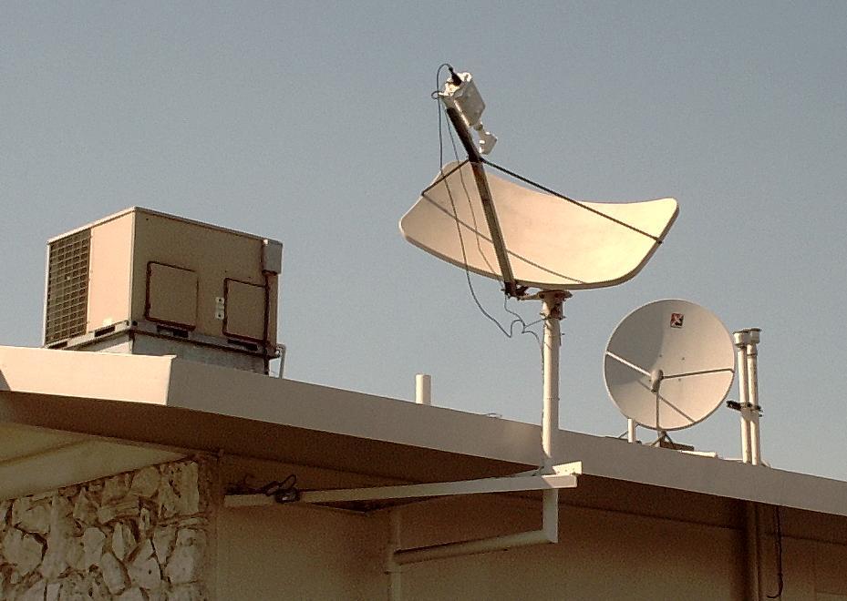

How about a Mobil gas station with a rectangular dish on the roof?
Does anyone have a guess as to what it is and can it be used for FTA?
You mean like this one?
Yes, I'm sure with a little refit at the LNB (remove the transmitter), it'd work fine for FTA.
I think this is a Prodelin, just based on some of the mechanical construction... and I thought someone around here had one in service. :)
Thats it. Anyone have any info on how to refit it.
Thanks
If you get it, post a close-up pic of the feed assembly (LNB and feedhorn), and we'll be able to tell more. Usually, these dishes use C-120-flanged feedhorns, which would accomodate a variety of LNBs.

It's a Prod...I have 2 of them...the neat thing about this dish is it is skewable...

Prodelin dishes:
I found this...
It's a 92cm Prodelin.
That family of -round- dishes is quite nice.
I've seen some of the 1.2m models in the field.
And, a few members here on the forum have them.

As for the -rectangular- Prodelin dish in my picture above, I -think- they are 1.2m wide (48 inches).
