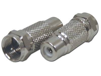

You would be much better off with a good grade of rg6 coax with "F" connectors on it. Adapters can then be screwed on the ends to convert them to RCA males.

I cannot use Coax as there are NO coax outputs on the HR20's ...

You can use RG6 and adapt the end to meet your connection needs. RG6 is just a cable; you most commonly see the "F" type connector; many people just say coax, but you can have various types of connector types.
